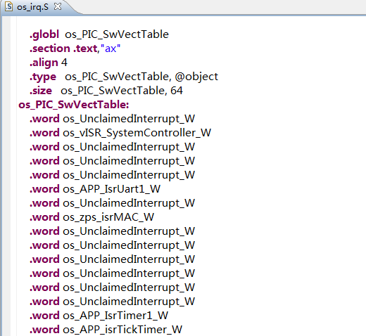

fangliang2316
Hi Sebastian,
I have checked UART1 pins,they are on high.
I confirm that I have set the priority level for UART1 in os_irq.s  file(I coundn't find irq_5169.s  in JN-AN-1201).
in the   file  App_ZHA_ZONE_JN516x.oscfgdiag, I config the Uart1 interrrupt.

fangliang2316
Hi Sebastian,
This is my os_irq.s  file:
/*begain*/

.globl os_PIC_SwVectTable
.section .text,"ax"
.align 4
.type os_PIC_SwVectTable, @object
.size os_PIC_SwVectTable, 64
os_PIC_SwVectTable:
.word os_UnclaimedInterrupt_W
.word os_vISR_SystemController_W
.word os_APP_IsrUart1_W
.word os_zps_isrMAC_W
.word os_APP_IsrTimer1_W
.word os_APP_isrTickTimer_W

I use the IAS profile  and I enroll my devices.
I succeeded in exporting debugging logs separately through UART0 or uart1. But I output logs through uart0, and through uart1 communicating with PC or mcu, uart1 cannot output data.Could you confirm this question, based on
JN-AN-1201.Thanks!

Sebastian_Del_Rio
Hi Liang,
Could you please try changing the vISR_Uart1 to APP_isrUart?
In the function, you'll have to specify which UART you'll be using to communicate:
PUBLIC void APP_isrUart(void)
    unsigned int irq = ((*((volatile uint32 *)(UART_START_ADR + 0x08))) >> 1) & 0x0007;
    uint8 u8Byte;
    if (irq & E_AHI_UART_INT_RXDATA) {
        uint8 u8Byte = u8AHI_UartReadData(UART);
        if(ZQ_bQueueSend(&APP_msgSerialRx, &u8Byte) == FALSE)
            /* Failed to send the message to queue */
    if (irq & E_AHI_UART_INT_TX) {
        if(ZQ_bQueueReceive(&APP_msgSerialTx, &u8Byte) == TRUE)
            vAHI_UartWriteData(UART, u8Byte);
            /* decrement activity counter for dequeued data */
        } else {
            /* disable tx interrupt as nothing to send */
            UART_vSetTxInterrupt(FALSE);
Also, can you send data if you're not using the debug?
Please let me know if that works.
