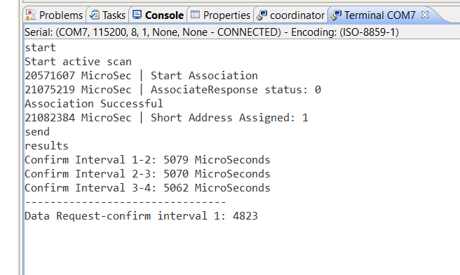

You are totally right. In my case, it was not only the delays caused by the MCU time read and the validations in the program but also, there was a huge delay caused by the DBG_vPrintf itself (in the order of 3000us).
I solved this by only taking the time in the moments I needed and,  printing these resulting times at the end.
I am also measuring the time between data confirmations to figure out if the PHY goes back to PHY_RX_ON between packets. Apparently, it did not.
I tested sending 4 packets and measuring their intervals
The transmission of data packets in a beaconless mode, with a Beacon Exponent (BE) of 0 (No random backoffs delays before CCA) and no ACK flag, with a payload of 114 bytes (max payload)  is:
1 byte = 2 sym 1 sym = 16 us (us = MicroSeconds) LIFS = 40 sym
114 bytes (data Payload) + 13 bytes (Mac header and trailer) + 6 bytes (PHY headers) = 127 bytes = 4256 us
Therefore, the interval between data packets of the same payload size should be:
4256 us (data) + 128 us (1 CCA) + 640 us (LIFS) = 5024 us
The interval values obtained are a little above 5024 us but I think is the overheads you mentioned.

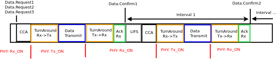

Now, for the case of Data transmission with Acknowledgment my mental image is this:
Or at least this should be true, but the NXP data rates calculation document mentions that in real cases the backoff delay overlaps the IFS for energy saving reasons. What happens if BE =0 and therefore, there is no backoff delay?
In the figure above of data transmission with ACK, and  with BE=0, does the IFS overlaps and therefore absorb the CCA and the TurnAround(Rx->Tx) time??
Furthermore,  you mention that the turnaround is between 180 to 204 μs, isn't this above the 192us that is supposed to be the maximum limit according to the IEEE 802.15.4-2006 std?

mario_castaneda
Hi Alberto,
BE shall be initialized to the value of macMinBE. So, if macMinBE is set to zero, collision avoidance will be disabled during the first iteration of this algorithm. After that, the BE will provide a value of BE = min(BE+1, macMinBE).
