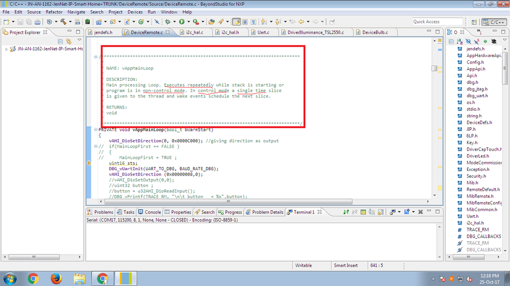

Hello Sir,
i have attached photo copy. in that APPmainloop() says in non control mode program executes repedately and in control mode it will execute only one time.
and this main loop restart after 20 sec i don't understand  how to stop this.
My I2C is not working because of this..
i am checking pulses its showing as per protocol but output is not showing proper. please need help
i think restart is my issue.
please suggest related to this problem..
thank You for your time!

dheerajsawant
Contributor V
Hello davidashraf‌ dereksnell‌,
I AM stuck at a point..
i am using JN-AN-1162 application note.
in that i am using DeviceRemote.c file
in that main loop is present  but that main loop restart after 20sec my i2c is not working because of that.
i am interfacing JN5168 with SHT31-DIS-B. its showing me output but not showing proper Heater Enable and Disable status
please help...
Thank you for your time
