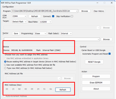

Hello! I Use JN5168 Chip,But I can't program it, I need help, Thanks!
1. I can read JN5168's MAC, so I think the connect is right.

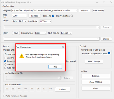

2. But when I Program It, Failed.

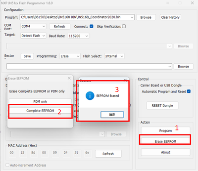

3. However, Althougth I can't program. But I can Erase EEPROM.
I don't know why the program failed, I need help, thanks very much!  JN5168

Thanks Luis for your reply,I try to program by JN-SW-4107. It successed, How happy! But I don't know why I use "NXP JN51xx Flash Programmer" GUI,It failed.

Great to hear that! The GUI is no longer supported so I would recommend switching entirely to the Flash programmer CLI tool in JN-SW-4107.
