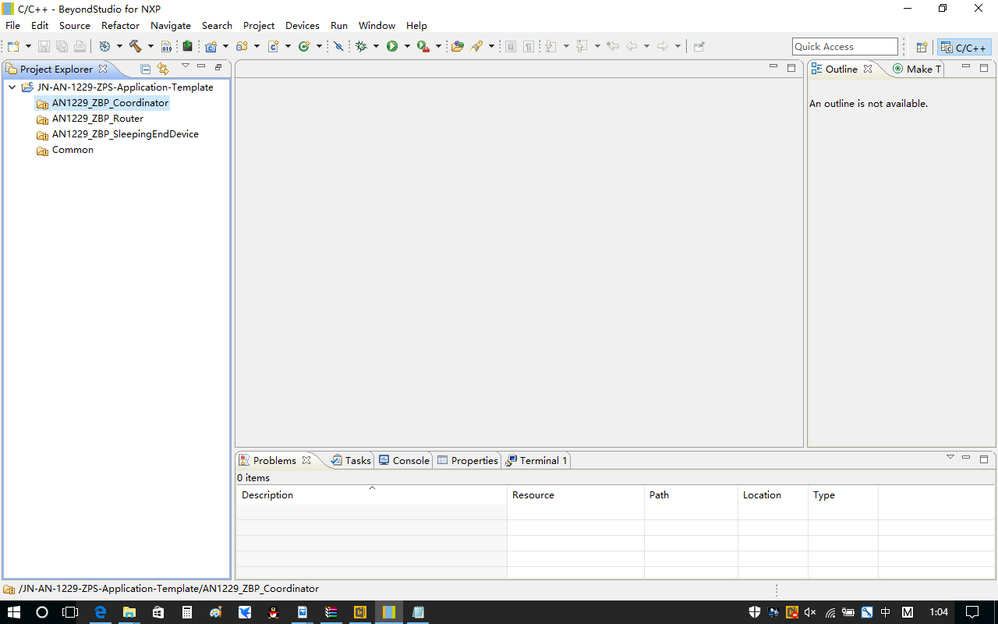

Hi Mario:
Follow the steps JN-AN-1229-ZBPro-Application-Template.pdf to import a project,Failed to construct, attempts like this, software installation, and how to solve it?
Using the Win10 operating system, import the JN516x project

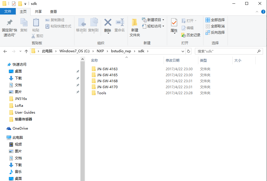

Hi JiWei Gao,
Did you extract the files in the next path?
C:\NXP\bstudio_nxp\workspace

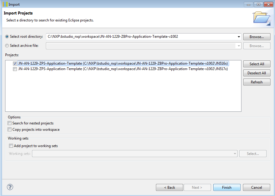

Could you please try to delete, download and import the project again?

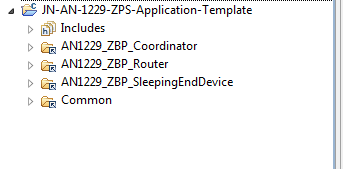

Then, when you try to import the project.  Please select only the JN5168 project like the image below.
Then, click "Finish" and you will able to see the project with the respective includes.
Please let me know your findings.

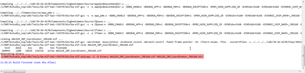

it create only .AN1229_ZBP_Coordinator_JN5169.bin only
and i am  using JN5168-001-M00 while uploading it ask me that bin file is different from controller but still click on yes.
and it was working very well.. but from today its showing
"Error programming flash on COM19
Image is not compatible with chip, image built for 0x0F03000B, connected device is 0x07030008"
1)why this is happened?
2)and how to create JN5168.bin file using same application.

Hi Dheeraj,
Just to confirm, could you please clean the project and compile it again?
As you know, the example creates a bin file for the JN5169, not for the JN5168.

yes yesterday i solve that issue.
i am using JN-AN-1229 application and its create bin file for jn5169.
and  i am using JN5168-001-M00 Module.
still i can upload JN5169 bin file into JN5168-001-M00 module while uploading once popup window come like
"bin file is not compatible with your module (click Yes or No)
but my work done by that JN5169 bin file.
what i want to ask:
1) can we change bin file JN5169 to JN5168. (in make file or any other way
2) Or it may harmful for my Module continuously uploading JN5169 bin file.

You can create the bin file for the JN5168.
Set the target device. makefile
# User definable make parameters that may be overwritten from the command line
# Default target device is the JN5168
JENNIC_CHIP ?= JN5168
JENNIC_CHIP_FAMILY ?=JN516x‍‍‍‍‍‍

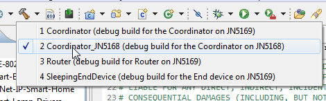

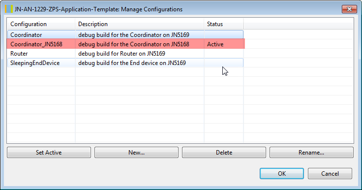

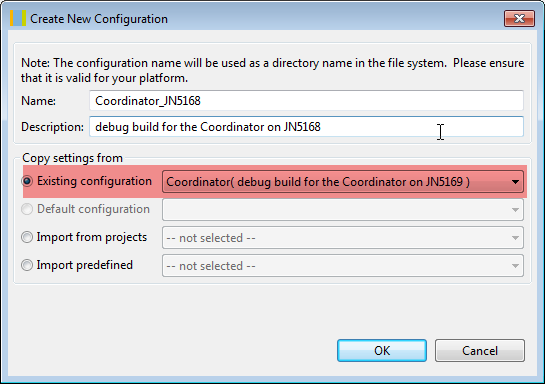

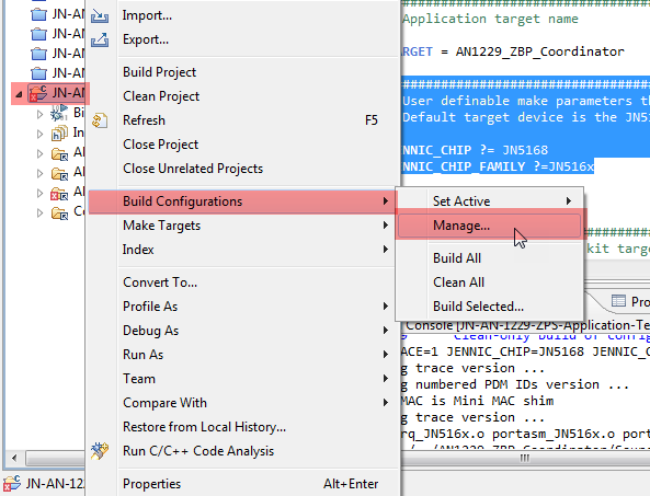

Then you can create your own Build configuration.
Create a new build configuration.
Select an existing configuration, you will copy the settings from the coordinator on JN5169 in this case.

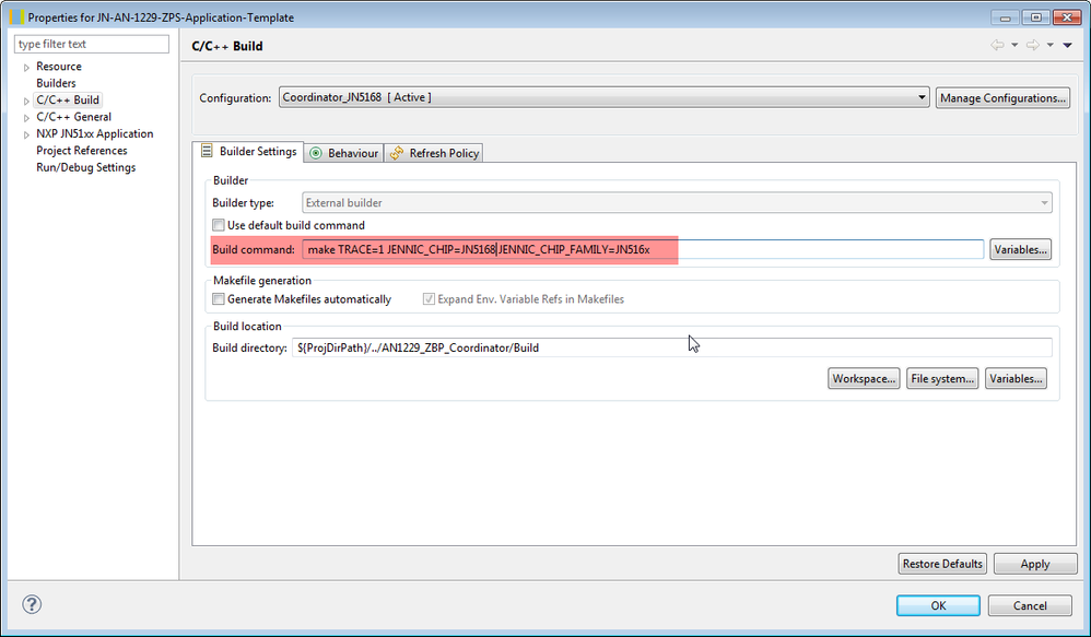

After that, please look up the example properties and change the build command for the JN5168
You can choose the Coordinator for the JN5168
Please let me know if you have problems creating the bin file
Mario
