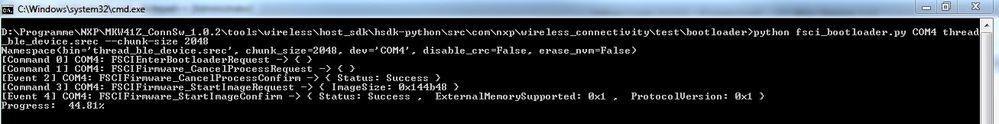

I tried flashing firmware via serial port with ./fsci_bootloader.py but it always breaks at 44.81% (-> gHandleBootError_d();) which resets the MCU.
Do you have any idea what is going wrong?
Additional info: OTAP works fine.
Thanks in advance.
3,661 Views
joachimk
Update / Solution:
-> Using .bin (raw binary) file instead of .srec file solves the problem.
