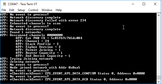

mario_castaneda
hI,
I am using the JN-AN-1216 Coordinator.
Are you working on the JN-AN-1229 or the JN-AN-1184?
if you are using the 1184. Did you add the code in the  app_router.c?
    /* Initialise ZBPro stack */
    ZPS_eAplAfInit();
    ZPS_vAplSecSetInitialSecurityState(ZPS_ZDO_PRECONFIGURED_LINK_KEY,
                                       au8DefaultTCLinkKey,
                                       0x00,
                                       ZPS_APS_GLOBAL_LINK_KEY);‍‍‍‍‍‍‍
I ran some test with 1229 and it could join the network successfully.
Mario

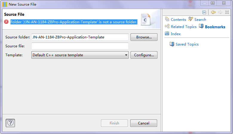

377086561
Thank you for your reply, I have already modified it. Not in the process of using BeyondStudio for NXP now, I want to add source files and header files but I get an errorZPY}I)HY8_4[X{~PQ(7}P4N.png
12,265 Views

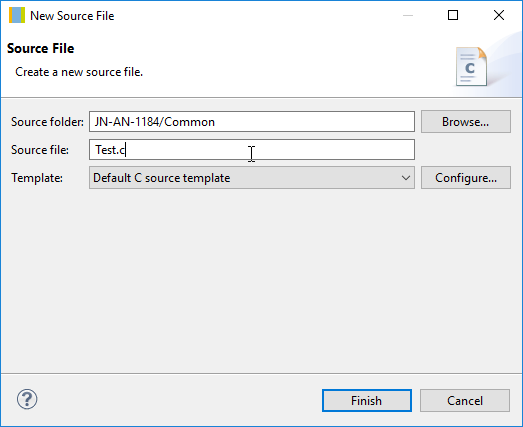

mario_castaneda
Could you please try changing another source file?
