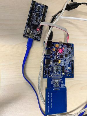

Hello expert, I was following PNEV5190B evaluation board quick start guide  using device PNEV5190BP and LPC link 2 probe.
Take the NfcrdlibEx8_HCE_T4T Projet for example, The problem is: After building the project and flashing into the board, the board can not aotumatically run. And in the debug mode and click the start button, the board can run the code. If I power off the board and power on it, the board don't have any reponse when I stick my phone to the antenna region(it should bellow up a tag with nxp website)
I wonder if I misset any pins or settings that caused flash erased.
Thank you in advance.

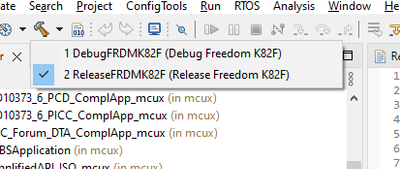

My apologies for the delay in answering back. Could you please also clarify that you are also chaining the Build Mode to Release?
My additional recommendation would be to please take a look at the MCUXpresso IDE Guide: https://www.nxp.com/webapp/Download?colCode=MCUXPRESSO-UG

Tylx
hello expert,
Thank you for solving my problem. I do not change the build mode. Now I can run the program!!!

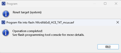

Tylx
Hi @Fabian_R
Thanks for your effort. I am flashing the board with GUI flash tool and I believe the axf file have programed into the board.In addition, I try to use j-link to flash the board. I found the j-link only run the compare section but no program and verify sections.
 However the board can only run in debug mode(the green button ) even though I've programed it.
 If I restart the board using the cable or press the Reset button(mk82), the board can not run(my phone has no response when I stick it to the antenna region)
 I wonder if there is a solution that the board can run the project normally even though I exit the debug mode.
