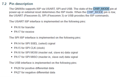

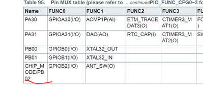

2 QN908x has rom bootloader. GPIOB2 is used for select chip mode. When you select isp mode, rom bootloader will start, then you can use uart or spi to flash. You can refer the reference manual.
3 You can refer this link. https://www.nxp.com.cn/docs/en/nxp/application-notes/AN12190.pdf

3 No, you needn't. When you use isp, you can use uart or spi to program.

2. Regarding ISP, uart or spi will be in receive/slave mode during isp programming and we can't program them through debugger. So, do i need to use another master controller for this purpose which will send the application image after power-on or is there any PC application for ISP programming?
