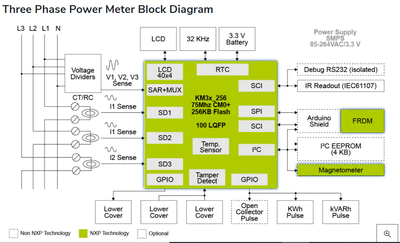

You may refer to a Reference design such as the Three-Phase Power Meter Reference Design or the Energy Gateway that might be useful for you project.
Please review the following block diagram from the Three Phase Power Meter. Are you interested in such design using the FRDM-KW41Z?
Please let me know if this information helps.
