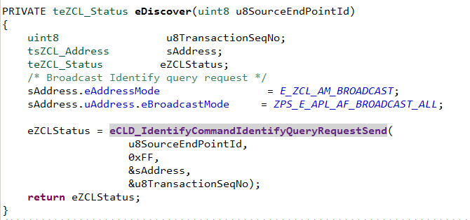

In HA, about the use of eCLD_IdentifyCommandIdentifyQueryRequestSend ()

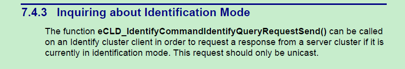

In (HAZLL JN-UG-3103.pdf) introduced in Figure:id_q.png
But in the JN1189 example, HaEzFindAndBind.c, the program is so used,
Can not you just UNICAST? Why do you use BROADCAST ...

During the Grouping stage, it is necessary to put into ‘identification’ mode (of the Identify cluster) all of the nodes with which the initiator will be paired.
Note: On generation of the event E_EZ_GROUP_CREATED_FOR_TARGET, the application on the initiator can optionally call the function eCLD_IdentifyCommandIdentifyRequestSend() of the Identify cluster in order to request the grouped target device to exit identification mode.
