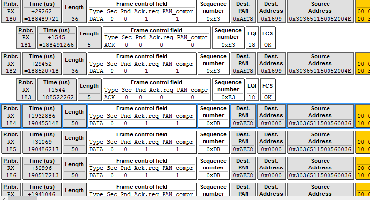

lixianmao
Hi.
 Recently I found a strange problem: coordinator do not send ack rightly.
 Here is the sniffer data.
A RFD with addr 0x1699 was sending data in a period of 2 seconds.
The coordinator got the data and supposed to send an ACK automaticly, but sometimes it didn't .
I checked the coordinator state is RX_SEQ ,and always is SEQ_STATE=20(dec). Don't know why it did not send ACK.
With this problem a lot of data will be discarded.
6,978 Views
georgecapraru
To send automatic ACK, the MCR20A must be configured to do so.
The device must have the MACPANID, MACSHORTADDRS and MACLONGADDRS registers setup correctly, so that the Packet Processor will not filter the incoming packet, and the AUTOACK bit of the PHY_CTRL1 register must be set.
But keep in mind that if the PROMISCUOUS bit of the PHY_CTRL4 register is set, then no ACK will be sent!
George
