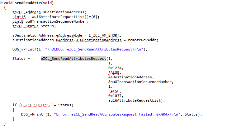

    The SDK I used is jn-sw-4168, and the Application Template I used is ZigBee PRO Application Template for JN516x (jn-an-1184). Now, at the coordinate end, send data to the enddevice end through ZPS_eAplAfUnicastAckDataReq interface,and receive data normally at the enddevice.But while reading enddevice's custom attribute data with eZCL_SendReadAttributesRequest interface did not return the data, and no generation E_ZCL_CBET_READ_INDIVIDUAL_ATTRIBUTE_RESPONSE or E_ZCL_CBET_READ_ATTRIBUTES_RESPONSE events
The function that reads the attribute data is (at coordinate) :
The services on the enddevice side are my own defined and register.

From your code seems that you added a custom cluster with Id = 0x1234. Is this cluster set accordingly on the remote device (like server or client functionality,  endpoint ...)? Also a sniffer capture will be useful for this scenario.
My recommendation is to check the read attribute command for a common cluster (let say Basic Cluster = 0x0000) and if it is working for this, means that you have a problem in setting the new cluster on the remote device.
Ovidiu

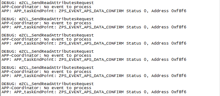

This is my read attribute log (at coordinate):
This is my read attribute log (at router):
this is my code:
my sdk is JN-SW-4170,my app template is JN-AN-1217-Zigbee-3-0-Base-Device
