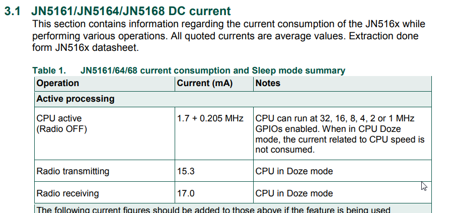

we are using JN_SW_4168 Stack and JN5169 controller for development of Home Automation device.
In our Home Automation application, We have configured zigbee device as end device type. So based on the configuration Rx On When Idle is selected as true in ZPSConfig editor.
We have configured application like, no use of any DIOs and LEDS, also all the timers used in application are stopped. At this stage, if we measure current consumption of the device, is approx. 15 mA.
So is there any way to minimize this current as low as possible ? Is there any configuration required in application to minimize the current consumption ?
Thanks.

you can't reduce current consumption as expected while using non-sleep ZED

Our requirement is Rx  should be on after device joined the network . So we have configure our device as a end device in the  ZPSConfig editor and we have not  use the sleep mode. so is there any way for Rx is on and current consumption can be reduce?

Please take a look at the 3.8 Doze Mode
https://www.nxp.com/docs/en/user-guide/JN-UG-3116.pdf?fsrch=1&sr=1&pageNum=1
Also, for a better reference, the JN-AN-1001 explains in more detail the JN516x Powe Consumption
