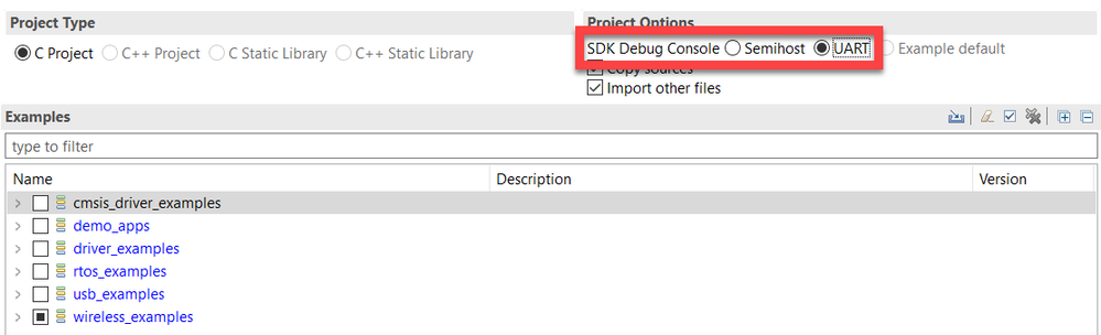

I am working on FRDM-KW36 development board and use (frdmkw36_wireless_examples_bluetooth_w_uart_freerots) SDK to build code by MCUXpresso IDE.
Questions :
Q1 : How to enable debug UART/console for prinrf ?
        If I use UART to print debug message on terminal which hardware pin are uart_tx and uart_rx?

  1. There's two methods for enabling the Debug UART in the MCUXpresso IDE:
    1. It can be enabled when importing the project by choosing the following option in the example selection window:
    2. After the example project is imported, the debug UART can be enabled by selecting this option in the Quick Start Panel on the MCUXpresso IDE:
      Regardless of which method is followed to enable the debug UART, the pins used for it (FC0_RXD is GPIOA17 and FC0_TXD is GPIOA16) are mapped to the Debug USB port, which allows the user to connect to the debug UART with the same USB cable used to debug the project.
