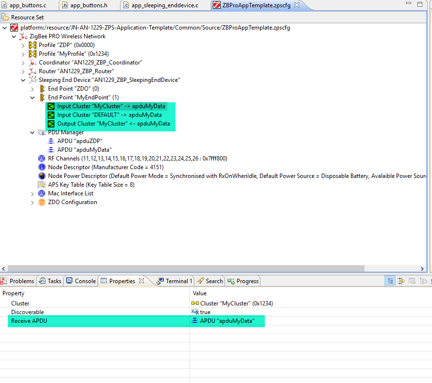

2,394 Views
mario_castaneda
Remember, the custom cluster that the JN-AN-1229 has assigned the Receive APDU to the apduMyData.
Could you please provide your implementation?
Also, please look at the next community post https://community.nxp.com/message/1012968
Mario

836733207
Thanks for your reply.
I add "#include "pdum_gen.h"" in the file where use apduMyData,and it finally work.
