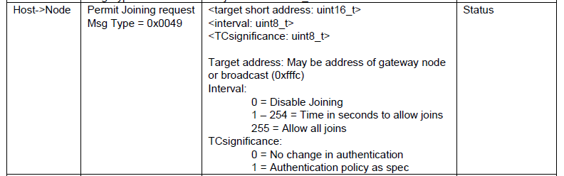

Hi There,
I have a zigbee sensor from some vendor whose source code is not accessible to me. It is having an issue when my gateway reboot, sensor took more than 30 min to rejoin the GW. This is not affordable. I want to change the rejoin request interval time of the sensor.
Is there any way to configure this time interval from remote coordinator (GW)?
Thanks in advance for any suggestion.

Hi Bhavya,
You can modify the Time in seconds to allow joins.
For a better reference please take a look Application Note: JN-AN-1216 documentation.
Mario
