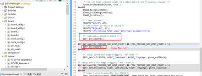

hello everyone,
I run the sdk driver example JN5189dk6_gint, which uses GINT0

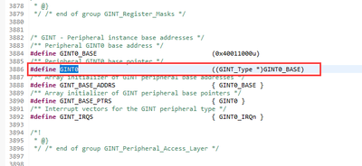

I want to use GInT0 and GINT1 because there are two I/O ports that may cause an interrupt at the same time.  but it compiled incorrectly because GINT1 was not defined. Only GINT0 is defined in the example
How do I define the GINT1 macro?
thankyou

Hope you are doing well. There is no GINT1. Please refer to section 2.1.2 of the JN5189(T)/JN5188(T) User manual.
Ricardo
