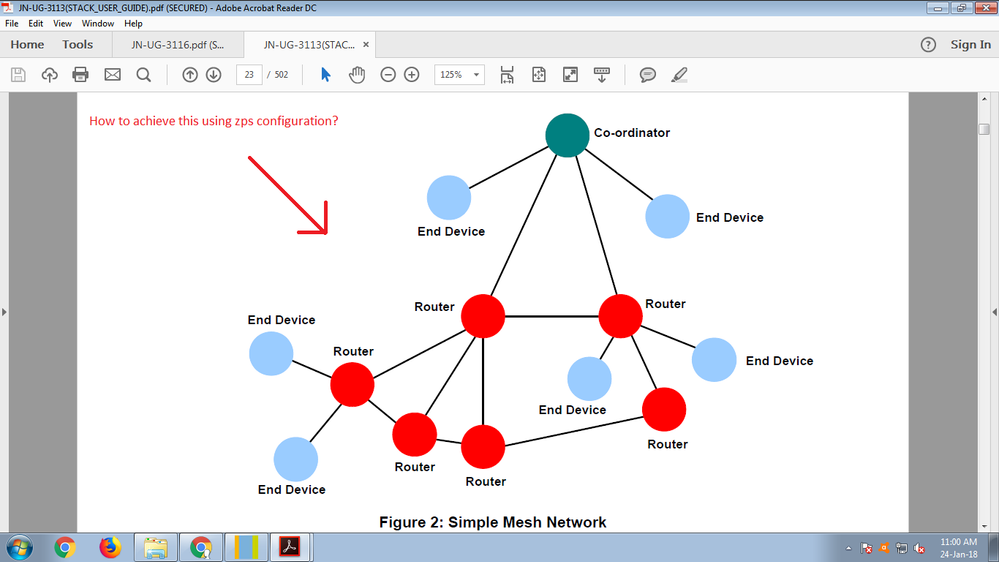

Hello mario_castaneda‌,
I want to increase distance of JN5168 Module using Router.
But Don't Know From Where should i Start?
I am reading "Route Discovery" from PDF JN-UG-3113.
In Simple i want to achieve Mesh Network.
How it will be Possible?
Dheeraj

dheerajsawant
Contributor V
Any one know how to configure mesh network using zps configuration?
Dheeraj

dheerajsawant
Contributor V
Yes mario_castaneda‌,
but  i little bit understand about this thread,
how i do this?
open zps configuration in beyond studio.
create new sibling of router as sleeping end device.
as router create child(SED) , that child(SED) will connect to coordinator through router.
because of that communication range increase.
(i think  my this problem is solved and looking for another thread which is "SENDING DATA FROM COORDINATOR TO SLEEPING END DEVICE".)
(if  i am doing somewhere wrong please inform me.)
BEST Regards,
Dheeraj

mario_castaneda
Hi Dheeraj,
Yes, The router opens up the network for other devices to join, child(SED) will connect to coordinator through router
Mario
