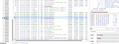

mario_castaneda
Hi @Mayankpatel,
We found a very strange behavior
Why is the ZR(0xB400) sending rejoin request which is only capable of ZED node?
this is not allow for ZR, what are the code modifications that you did?
Mario
7,941 Views
Mayankpatel
Hi @mario_castaneda,
We make the below changes in the application:
Function: BDB_vStart
            case ZPS_ZDO_DEVICE_ROUTER:
                ZPS_eAplZdoStartRouter(TRUE); //FALSE: Don't send Device Announce
                eInitState = E_INIT_IDLE;
                sBdbEvent.eEventType = BDB_EVENT_INIT_SUCCESS;
                APP_vBdbCallback(&sBdbEvent);
                break;
Function: APP_vBdbCallback
        case BDB_EVENT_INIT_SUCCESS:
		    DBG_vPrintf(TRACE_APP,"APP: BDB_EVENT_INIT_SUCCESS\n");
		    if (eNodeState == E_STARTUP)
			   eStatus = BDB_eNsStartNwkSteering();
			   DBG_vPrintf(TRACE_APP, "BDB Try Steering status %d\n",eStatus);
		    else
			   DBG_vPrintf(TRACE_APP, "BDB Init go Running");
			   eNodeState = E_RUNNING;
			   BDB_vRejoinCycle(TRUE);
			   PDM_eSaveRecordData(PDM_ID_APP_ROUTER,&eNodeState,sizeof(teNodeState));
		    break;
What will be the issue facing when ZR Device Sends "Rejoin Request" to the ZigBee Control Bridge?
7,925 Views
mario_castaneda
Hi @Mayankpatel,
It seems that you are mixing the ZED and ZR behavior together.
Also, I still recommend moving on to the last Zigbee MCU JN5189.
Mario

mario_castaneda
Hi @Mayankpatel,
As the JN5179 has very limited support.
What we can suggest is first don't mixing ZR and ZED features together :
if you want to use the device as ZR, remove rejoin request message send from the ZR ;
if you want to use the device as ZED, remove the link status message send from the ZED.
Mario
