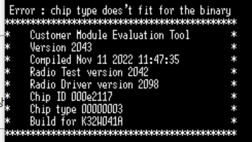

Hi.
I'm going to test RF performance for K32W041.
so, I flash the customer module evaluation tool on K32W041.
but I don't start the test program with error message.
[E: chip type dosen't fir for the binary]
please help

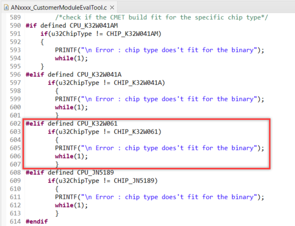

You can try re-building CMET for K32W061 with a modification. For instructions on how to rebuild CMET, please consult JN-AN-1242 > Docs > JN-AN-1242-Customer-Module-Eval-Tool document, Section 3 Downloading the Application.

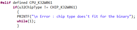

For the modification, open ANxxxx_CustomerModuleEvalTool.c and search the following portion of the code:

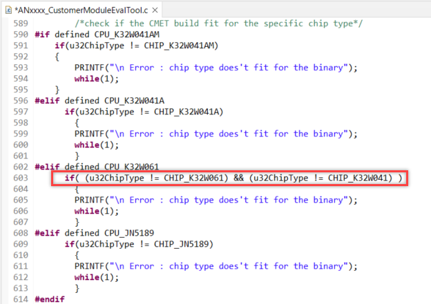

Here, change the condition to:
if( (u32ChipType != CHIP_K32W061) && (u32ChipType != CHIP_K32W041) )
After this, re-build the project, flash the new binary into your device and test the application. Please, let me know your findings.

Please, try using CMET for K32W061, this project should work as base for the K32W041. When importing the project to your workspace, select JN-AN-1242-K32W061
After this, open ANxxxx_CustomerModuleEvalTool.c and search the following portion of the code:
Change the condition to
Then, build the project and flash the binary to your device. This modification should allow you use CMET on K32W041.
Eduardo.
5,088件の閲覧回数
swhyun
Thank you. It was very helpful.
I built and tested it the way you told me, and I checked that it works normally on the K32W041 product.

I am using K32W041, not K32W041A and K32W041AM. There is no list of K32W041 in CMET, is it not possible to support it? Or can I use the bin of K32W041A?
5,246件の閲覧回数
EduardoZamora
Hello @swhyun
Hope you are doing well.
Could you please try using the binary located inside JN-AN-1242 > K32W061_mcux (Debug/Release) folder?
