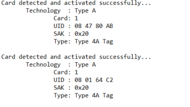

Hi ,
I am trying to read my phone UID using the DiscoveryLoop Example That NXP provides. But I am getting different UIDs. How can I get a fix UID of the phone ?
Thanks im advance.

Hello sir,
Unfortunately, this is an Android characteristic. Our example only reads the UID of the device but, is up to the phone to provide a static or dynamic one. I'm very sorry for the issues that this might take. I'll recommend you to please check this with Android support.
I hope you have a great day sir!
