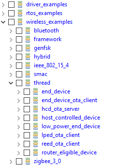

4,667 Views
varun_sahni
4,667 Views

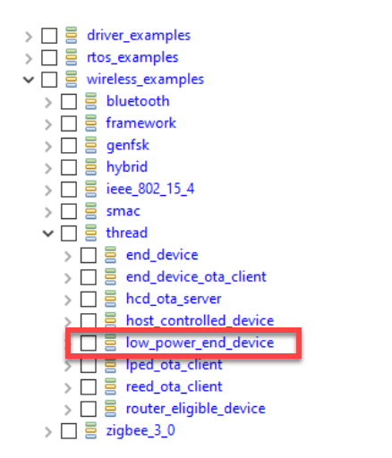

stephanie_m
In the pictuire you show, under the thread folder you can see
That is the example with low power for the end device.
