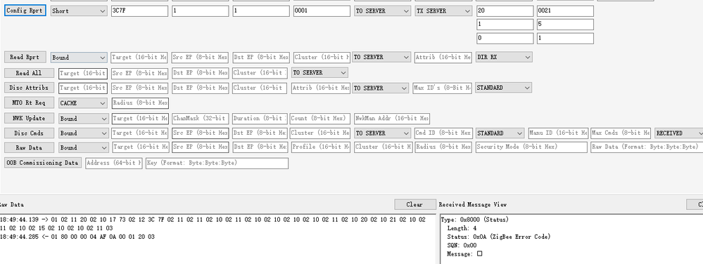

lucasip
Hi Jainil,
I set config report to get the sesor battery remaining.
I have tried by configuring attribute reporting for my sensor with ZGWUI tool (cluser 0x0001 power config ,attribute ID 0x0021 battery remaining)
But it return the error (error code 0x0A)
I guess I was set the direction TO SERVER ,because the direction TO CLIENT was return success even if it did not work
can you please help me out?
