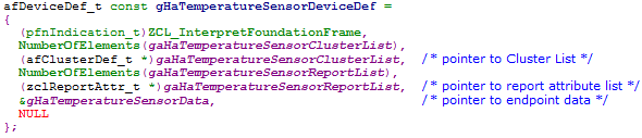

We are working on BeeStack 5.0. We add the test code AppReadTemperature() in BeeAppHandleKeys() in pure Beestack5.0 as following , we found the return value of ZCL_GetAttribute is always not gZbSuccess_c.
if(gZbSuccess_c==ZCL_GetAttribute(appEndPoint,aClusterId,gZclAttrTemperatureMeasurement_MeasuredValueId_c,gZclServerAttr_c,&tmp, &Attrlen))
{  Temperature = OTA2Native16(tmp); /* Convert to Big Indian */}
else{
Temperature=4477;}
We dig into the ZCL_GetAttributePtr and found the pData is 0x0000
  if (ZclAttrIsInSceneData(flags))
    pData = pDeviceDef->pSceneData;
  else
    pData = pDeviceDef->pData;
  if(ZclAttrIsInstance(flags))
    if ((NULL != pDeviceDef) && (NULL != pData))
    {  pAttrPtr = &pData[pClusterDef->dataOffset + pAttrDef->data.offset];
     else
          // go to this case }
  else
    pAttrPtr = pAttrDef->data.pData;

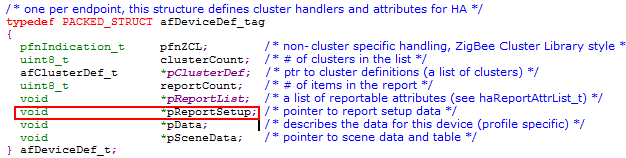

We checked the afClusterDef_t const gaHaTemperatureSensorClusterList[] in HaTempSensorEndPint.c, 5 parameters but in typedef afClusterDef_tag in AppAfInterface.h (as listed below), there are 6 parameters. We also check previous BeeStack, there are 6 parameters in gaHaTemperatureSensorClusterList[] .
/* Used by BeeKit to pull in only the handling code needed for a set of clusters */
typedef PACKED_STRUCT afClusterDef_tag
  zbClusterId_t    aClusterId;    /* cluster ID */
  pfnIndication_t  pfnServerIndication; /* server indication handler for this cluster */
  pfnIndication_t  pfnClientIndication; /* client indication handler for this cluster */
  void            *pAttrSetList;     /* ptr to attribute set list (zclAttrSetList_t) */
  uint16_t         dataOffset;    /* offset of this cluster's data within instance data */
#if gAddValidationFuncPtrToClusterDef_c
  pfnValidationFunc_t pfnValidationFunc; /* ptr to the attribute validation function */
#endif
  void            *pCommandsDefList;  /* ptr to commands def list (zclCommandsDefList_t) */
} afClusterDef_t;

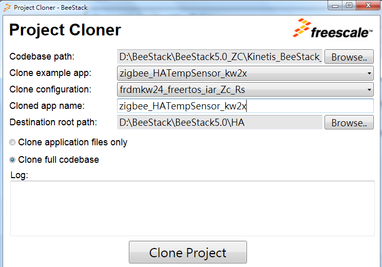

we downloaded the Beestack5.0 from the link below and used clone tool to exctract ZC and ZED.  The test method is using ZCL command of Test tool to get the temperature attribute.

I woud like to know the "afDeviceDef_t const gHaTemperatureSensorDeviceDef"  have 7 members in HaTempSensorEndPoint.c and afDeviceDef_t have 8 members in AppAfInterface.h? It is the root cause right?  If my analysis is wron, please correct me.

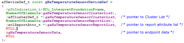

In these days, we found that the structure of gHaTemperatureSensorDeviceDef  is mismatched in beestack 5.0. The attriubute, "gZclAttrIdTemperatureMeasurement_MeasuredValueId_c" can be read successfully after we add a NULL.  But we still don't know if it will cause any side effect.

That pReportSetup pointer is new to me. I am not sure if I understood correctly, but you should not build a function for reporting. as long as you configure your attributes as reportable, you have the ZCL foundation to handle reporting of attributes. This means that from the client you can access the server to enable auto reporting. you can configure to report every x seconds, or else every time the value changes, etc... I know this should be supported by the stack itself, you don't need to create extra functions. So my suggestion is, you need to download one of the code examples without modifications, like on/off light and on/off switch, and use Test Tool on the client (that will be the switch), to enable reporting of the on/off light. I don't remember if these two demos have their attributes enabled by default... probably you need to use different example. Have you used test tool before? You can send serial commands to your ZigBee node, to monitor or inject messages at any layer of the protocol stack. For this you need ZCL foundation messages, like Read attribute, enable reporting, etc. I NXP have documents describing this, you should navigate on the BeeSTack docs.
Once you have that demo running, you have a living example on how to make sure all the metaproggraming should be configured to enable reporting on a specific attribute. So you will have an example on what you need to have as "pReportSetup "...
