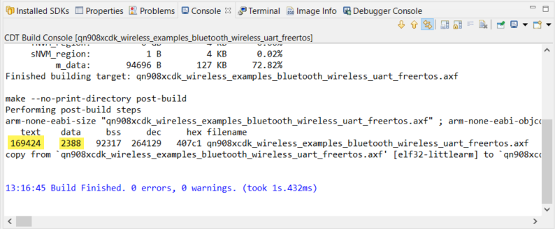

If BLE uses flash, where does the address start?
If I start with 0x2101 E000, does Wireless UART use 170,594 bytes, so I use 0x2102 9A62?
Then, since the example uses the address from 0x2101 E000, is the connection disconnected due to overlapping space?
I want to confirm that the flash address of Wireless UART will start 0x2100 0000.
And, Is there a way to get an empty flash address?
How can I know how much flash memory is being used on QN9080 chip?

After you build a project, you can know the flash consumption directly in the MCUXpresso console:
Typically the Flash consumption of the application will be text + data. This can be found in section 17.5.2 of the MCUXpresso IDE User Guide.
