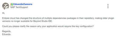

In the post you see what your collegue says about the Zigbee plugins:
So Do you have a zip-file with the latest plugins so that my beyondstudio will work?

Unfortunately, some plugins are no longer available.
I apologize for the inconveniences.
