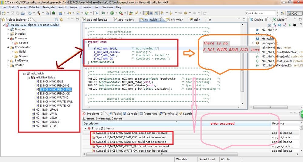

Open a source file (.c) or a header file (.h),  there are  a lot of errors.
According to  Beyond Studio Common Errors ,
What should I do next?
Ignore the errors or solve those errors?
how to resolve the errors?
Is this a correct method?
Thanks!

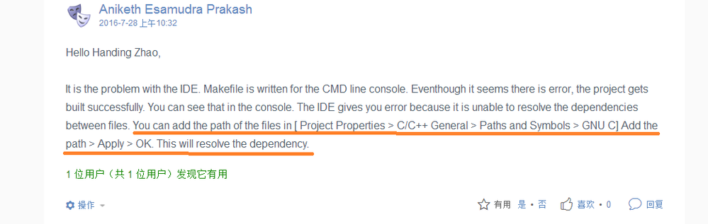

pierrelgcb
Adding C:\NXP\bstudio_nxp\workspace\JN-AN-1217-Zigbee-3-0-Base-Device\Common\Source
to GNU C include directories fixed "cannot resolve" errors for me.
After this action, I got a warning "redundant path" because directory was declared twice. Default directory with "/" and custom directory with "\".
After removing custom directory, leaving only built-in directories. Warning disappeared. I have an empty "Problems" tab. I can use Declarations links (F3).

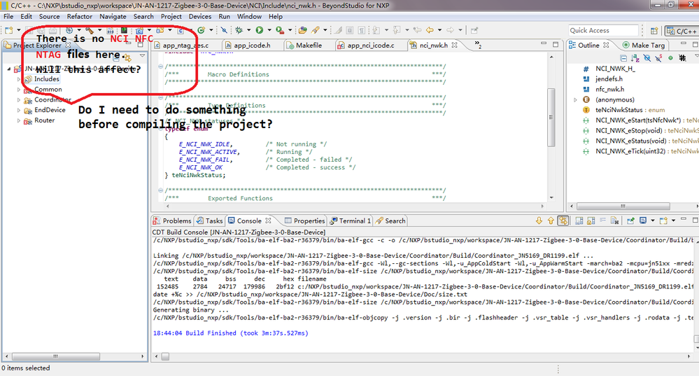

Hi Zhang,
I'm sorry, Unfortunately, the errors can't delete it
You can ignore and take as a reference only the console log.
Sorry for any inconvenience.

mario_castaneda
Hi Zhang,
I'm sorry, unfortunately, most of the errors can be eliminated. But as you can see, the image is showing the console log and the project is generating the .bin file.
Mario

In this way, some errors have been eliminated.
There are still a few errors.

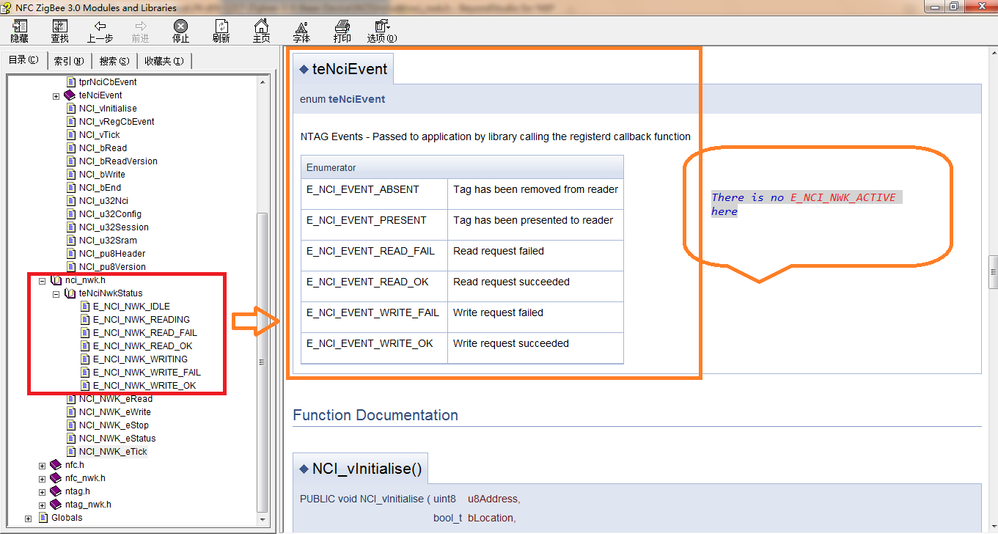

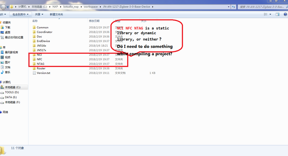

I found that most of these errors are related to NFC.
Reference material:
JN-AN-1217-Zigbee-3-0-Base-Device                v1004
NFC ZigBee 3.0 Modules and Libraries
Where did it lead to the errors?
Please give me some helpful help
