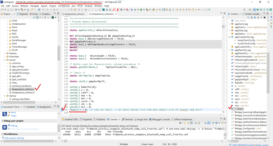

However, when a real data type variable (for example, float) is declared to output 24.xx degrees Celsius, a connection error occurs in BLE communication.
Currently, I have declared a float variable called "float_t r" in the BLE_temp_collector.c example.

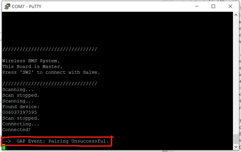

However, even though I only declared a floating-point variable, after building and debugging, when I check the value output from Putty, it says that pairing was not successful as shown below.
Why does this result occur?

Although the example has been modified, the overall framework is the same.
I simply declared a float data type variable to output the temperature, which had been declared and output as uint16_t, in real number format.
If you look at the picture I attached before, it means float_t r.
I currently have it commented out, but after uncommenting it and debugging, an error occurs in the pairing part when I try to communicate with BLE.

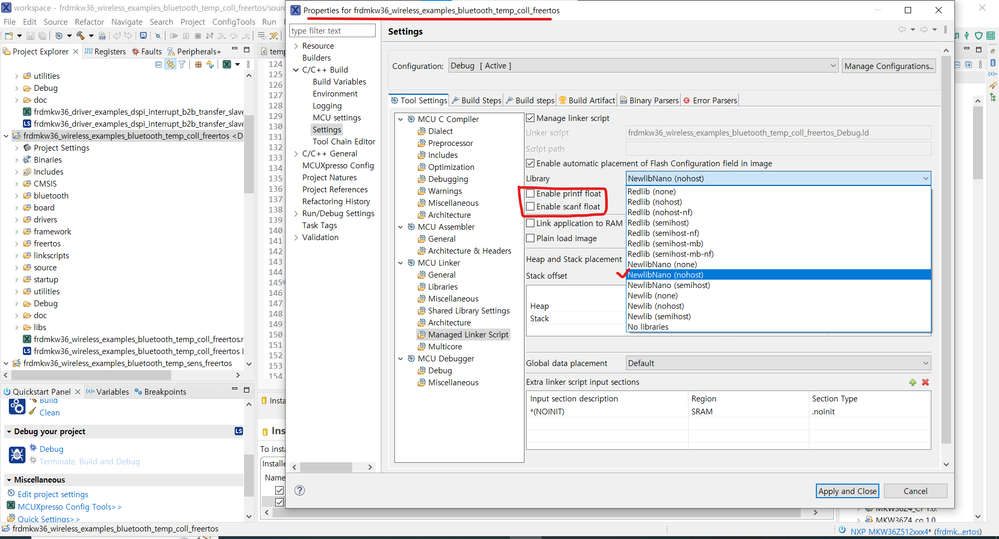

In addition to the questions I asked previously, I have an additional question.
SeokJin_0-1712200977659.pngSeokJin_0-1712200977659.pngWhen I change the Library to "NewlibrNano (nohost)" in the "Properties" of BLE temperature_collector, "Enable print float" is activated and it looks like I can check it and apply it. Is it okay to change the library?
The existing library was "Redlib (nohost-nf)".
SeokJin.
