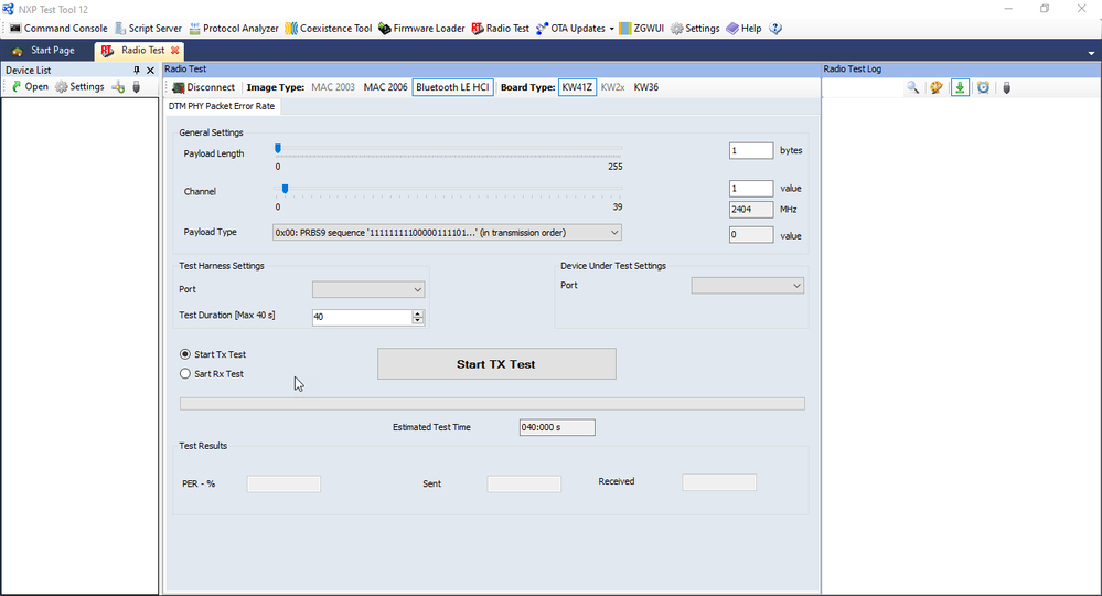

mario_castaneda
Hi Ramya,
If you want an example to test your design you could look at the HCI Black Box example that we provide.
In the Controller Mode, only the link layer runs on the KW41. The host protocol, profiles, and application all run on the external microcontroller or PC. These two components communicate via HCI. Generally, this mode is not used in the product design except for product testing.
Then you will need the Test tool and KW41 board. You will have a tester and tested device.
The test will be sent or received data to the other board and will provide the test results of the percentage data that was received or transmitted.
"\KW41_SDK\boards\frdmkw41z\wireless_examples\bluetooth\hci_black_box"
Note: This is not a certification test, but could give you an idea.
Test Tool for Connectivity Products
Please let me know if you have any other questions.
