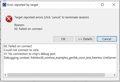

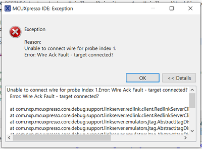

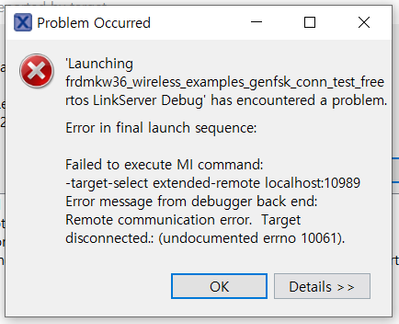

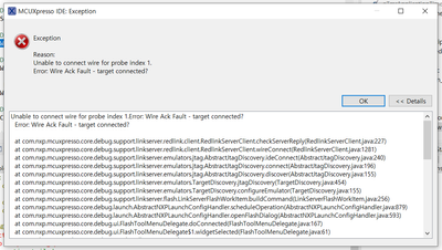

I found that when I quit after debugging the BEL example of the KW36 SDK, a debug error occurred from then on.
SeokJin_0-1703083025688.png Among them, an error occurs after debugging the ble_fscibb example.
The error details are the same as the error encountered previously.
After debugging the example, I just clicked Terminate without executing any action, and the error occurred after that.
Why does this happen?

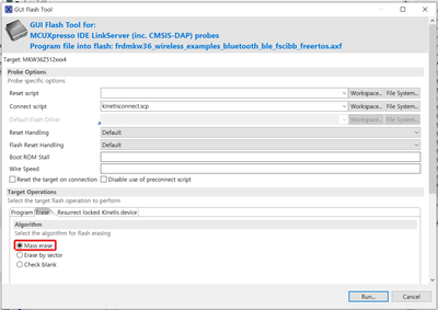

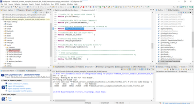

SeokJin
Hello, Ricardo.
I am replying because the problem was not resolved after applying the method suggested as a solution.
First, I disabled low-power mode through macro modification.

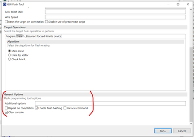

SeokJin_0-1703142968247.png Build has been completed.
Afterwards I tried "mass-erase".
SeokJin_2-1703143177249.png 'mass erase' was run in MCUXPresso, and the related settings were set as shown in the photo.
After setting it like this, I ran it, but an error occurred.

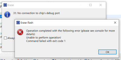

SeokJin_4-1703143465552.png This is the error content.
An error message also appears in the console window.
As a result, 'mass erase' also doesn't seem to run due to a related error. What's the problem?
