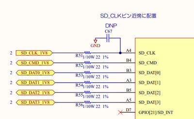

Hello all,
I have a custom board based on iMX8MP with U-Blox Maya-W266 wifi module integrated. (Schematic diagram snippets attached).
SD2_X pins from U-Blox are connected to GPIO2 port of iMX8MP as shown below:

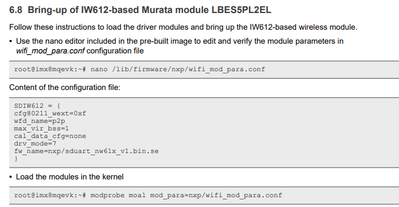

After booting the board, I followed instructions from "Getting Started with NXP-based Wireless Modules on i.MX 8M Quad EVK Running Linux OS" to bring up the wifi module:
However, I do not see any related messages in dmesg command output. I verified the configurations of wifi_mod_para.conf to be correct. Also, the firmware binary file is present inside nxp directory.
I have no idea on what to check for in further steps. I am not sure whether modifications in device tree are needed since the hardware designs are basically identical to the im8mp-evk design.

Regarding the schematic, I have attached an image in original question. The pins from UBlox are connected to SD2_xxxx pins of the processor.  These pins belong to USDHC2.

usdhc2 is at address 30b50000. It is aliased as mmc1. So, mmc1 is probably where the WiFi module is connected. But there is only one message in kernel log related to mmc1:
[ 3.312631] mmc1: SDHCI controller on 30b50000.mmc [30b50000.mmc] using ADMA

I tested the signals in SDIO line. The clock seems fine. But the command is not correct. It needed to be 0 but it is something else. So, I guess the settings in device tree I am using is still wrong.

I don't think WiFi module is connected to other sd interfaces.
