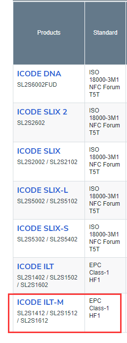

I cannot read the tag. How can I read the ICODE ILT-M tag?
When I use RC663 with the SW335613 library to read a ICODE ILT-M tag, it is always return wrong, the error code is collision or protocol error. But I only place one tag.

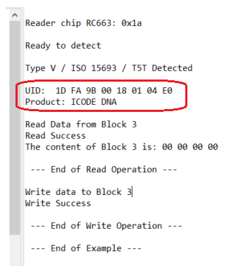

Please try to download SW297857 package, there is an example (SW297857\Examples\NfcrdlibEx5_ISO15693) for accessing ICODE TAG. On my side, I have tested, and everything is working.

But I use the ICODE ILT-M tag that protocol is ISO18000-3 mode 3.
The examples you say I have already tried, it is not work on ICODE ILT-M tag.

You could check your TAG and make sure whether it is OK or not.On my side, the same reader and example can read/write Mifare UltraLight and ICODE (because I only have these two).This example supports ISO18000p3m3 card/tag access, so problem is most likely on your card side. Or you can install TagWrite(this is from NXP) on your phone and try to access your device from your phone.

I did the same way, too. the reader and example can read ICODE Slix and MIFARE Plus, but it is not working with ICODE ILT-M tag.
I also used the oscilloscope to check. And I found the tag is working, and it can return the correct signal, but the example received the wrong byte that comparison of signal.
I want to know is there something wrong in example about ISO18000p3m3 part?
