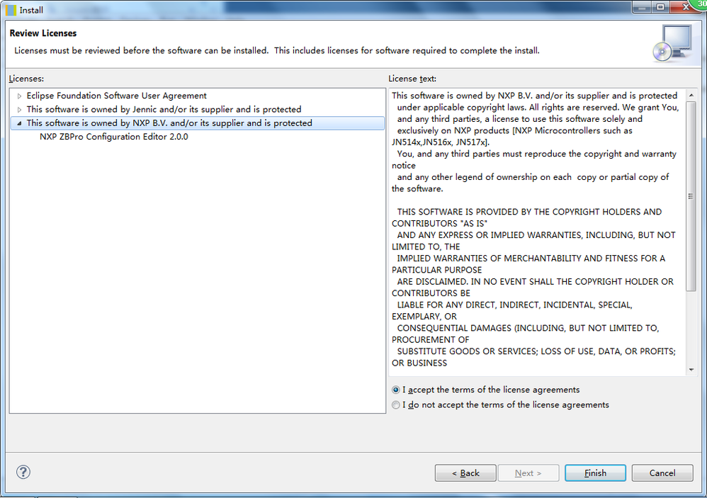

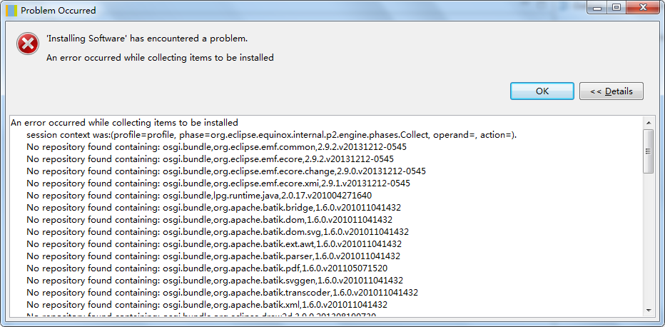

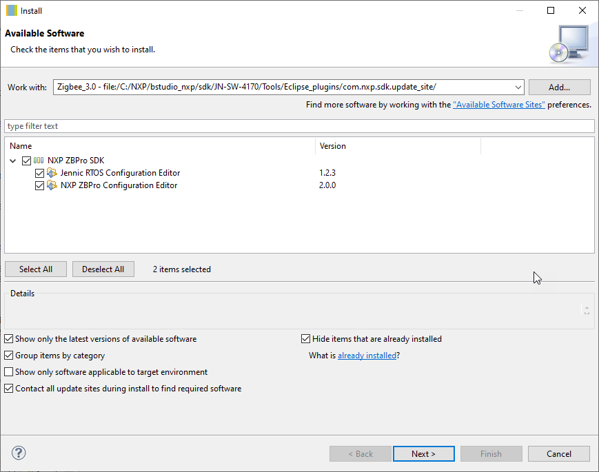

When I install the software BeyondStudio for NXP (JN-SW-4141) to the third step, Installing the ZigBee Plug-ins, the error shown in the figure below will appear, causing the installation to fail. I tried many times but it didn’t work, I don’t know what went wrong.
 Thanks for your answer!

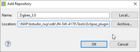

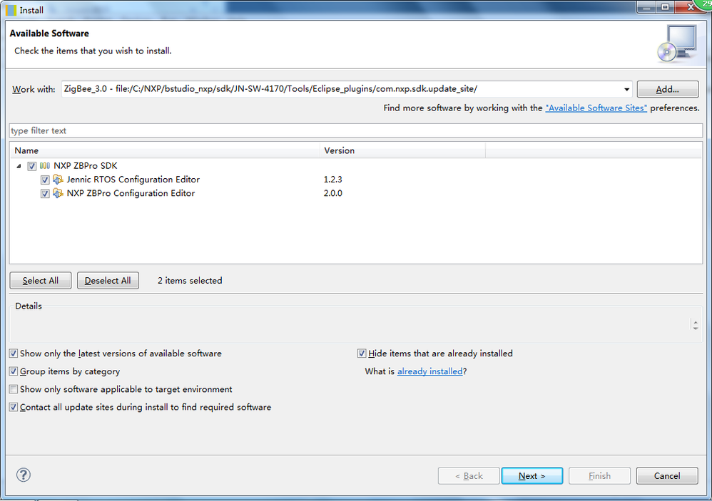

What is the SDK that you are selecting for installing the plugin?
Please use the next path to find out the plug-in
\NXP\bstudio_nxp\sdk\JN-SW-4170\Tools\Eclipse_plugins\com.nxp.sdk.update_site
Please see the images below.
Please let me know your findings.
Mario

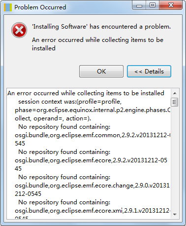

I use JN-SW-4170, and I installed it according to the manual of JN-UG-3098. After uninstalling and reinstalling several times, an error pop-up still appears.
I tried again, still the same

Could you please uninstall beyond studio and install it again? For any reason, the IDE is not founding the plugin.
Mario
