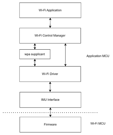

Figure 1 is the Wi-Fi software architecture.
Figure 1: Wi-Fi Software ArchitectureFigure 1: Wi-Fi Software Architecture

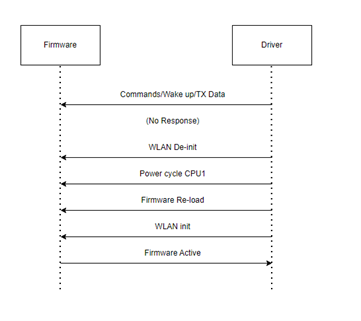

Figure 2 shows the work flow of Wi-Fi automatic recovery:
Figure 2: Wi-Fi Automatic Recovery Work FlowFigure 2: Wi-Fi Automatic Recovery Work Flow
  • Wi-Fi driver detects command timeout/wakeup card timeout/FW exception
  • Wi-Fi driver triggers WLAN reset to
    • Stop Wi-Fi activities and de-initialize Wi-Fi
    • Reset Wi-Fi power
    • Reload the Wi-Fi only firmware and wait for the firmware to be active
    • Send an event to notify the application before resetting it
