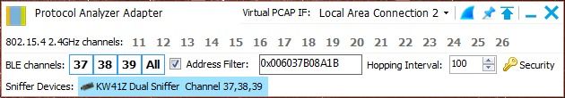

Configure Kinetis Protocol Analyzer and Wireshark Network Analyzer
Note: For better results, address filter can be activated.
When you are capturing all the packets in the air, you will notice 3 adv packets. Each packet will show the adv channel that is getting the adv frame.

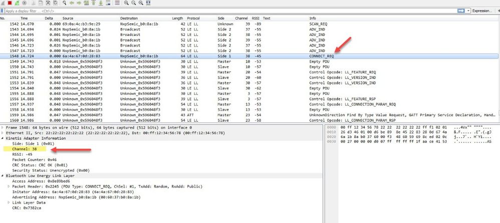

One of the three sniffers will capture the Connection Request. In this case, it happens on channel 38.
You will be able to follow the connection, see all the data exchange.

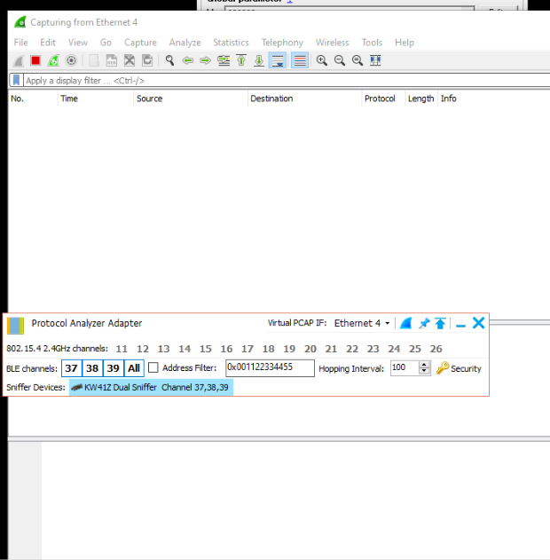

CaptureWireShark.pngHello,
I followed your steps and programmed the USB dongle as sniffer as mentioned above, but in the end, when I'm opening Wireshark from Protocol analyzer adapter tool, there is nothing captured, even tested with a scanner and there are 2 advertisers in the room. How can I identify the problem? is there any log to check?
Thank you in advance!
Nicu
