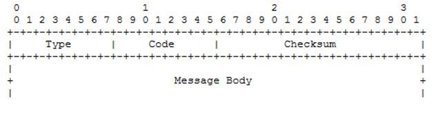

ICMP
Thread devices support the ICMPv6 (Internet Control Message Protocol version 6) protocol and ICMPv6 error messages, as well as the echo request and echo reply messages.
The Internet Control Message Protocol (ICMP) is an error reporting and diagnostic utility and is considered a required part of any IP implementation. ICMPs are used by routers, intermediary devices, or hosts to communicate updates or error information to other routers, intermediary devices, or hosts. For instance, ICMPv6 is used by IPv6 nodes to report errors encountered in processing packets, and to perform other internet-layer functions, such as diagnostics.
ICMP differs from transport protocols such as TCP and UDP in that it is not typically used to exchange data between systems, nor is it regularly employed by end-user network applications.  The ICMPv6 messages have the following general format:
  • The type field indicates the type of the message.  Its value determines the format of the remaining data.
  • The code field depends on the message type.  It is used to create an additional level of message granularity.
  • The checksum field is used to detect data corruption in the ICMPv6 message and parts of the IPv6 header.
ICMPv6 messages are grouped into two classes: error messages and informational messages.  Error messages are identified as such by a zero in the high-order bit of their message Type field values.  Thus,   error messages have message types from 0 to 127; informational messages have message types from 128 to 255.

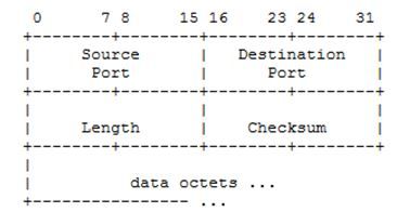

UDP
The Thread stack supports UDP for messaging between devices.
This User Datagram Protocol  (UDP)  is defined  to  make available  a datagram   mode of  packet-switched   computer communication  in  the environment  of an  interconnected  set  of  computer  networks, assuming that the Internet  Protocol (IP) is used as the underlying protocol.
With UDP, applications can send data messages to other hosts on an IP network without prior communications to set up special transmission channels or data paths. UDP is suitable for purposes where error checking and correction is either not necessary or is performed in the application, avoiding the overhead of such processing at the network interface level.
The UDP format is as follows:
  • Source Port is an optional field, when meaningful, it indicates the port of the sending  process,  and may be assumed  to be the port  to which a reply should be addressed  in the absence of any other information.  If not used, a value of zero is inserted.
  • Destination Port has a meaning within the context of a particular internet destination address.
  • Length is the length in octets of this user datagram including this header and the data.   (This means the minimum value of the length is eight.)
  • Checksum is the 16-bit one's complement of the one's complement sum of a pseudo header of information from the IP header, the UDP header, and the data, padded  with zero octets at the end (if  necessary)  to  make  a multiple of two octets.
