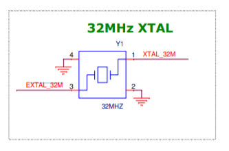

By default, FRDM-KW36 board includes a 32MHz XTAL (YI) as shown in Figure 1 but there are cases where a 26MHz XTAL is needed instead of 32MHz XTAL for FRDM-KW36 or a custom KW36 board.
Figure 1. 32MHz XTAL from FRDM-KW36 schematics

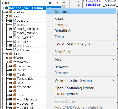

  • Right click on your project, then click options (Figure 3).

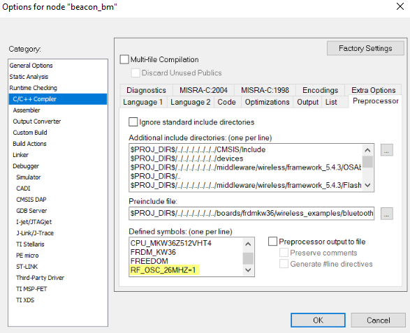

  • Go to C/C++ Compiler tab, then Preprocessor, and add RF_OSC_26MHZ=1 line in defined symbols window (Figure 4).

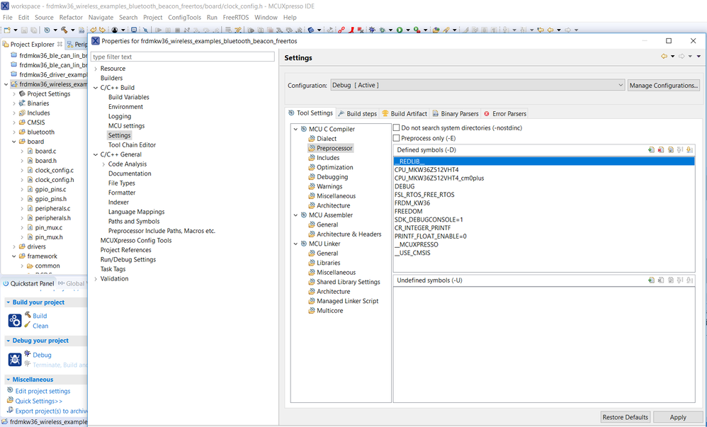

  • Right click on your project, select Properties, go to Settings under C/C++ Build, then Preprocessor under MCU C Compiler (Figure 5).
Figure 5. MCUXpresso Preprocessor

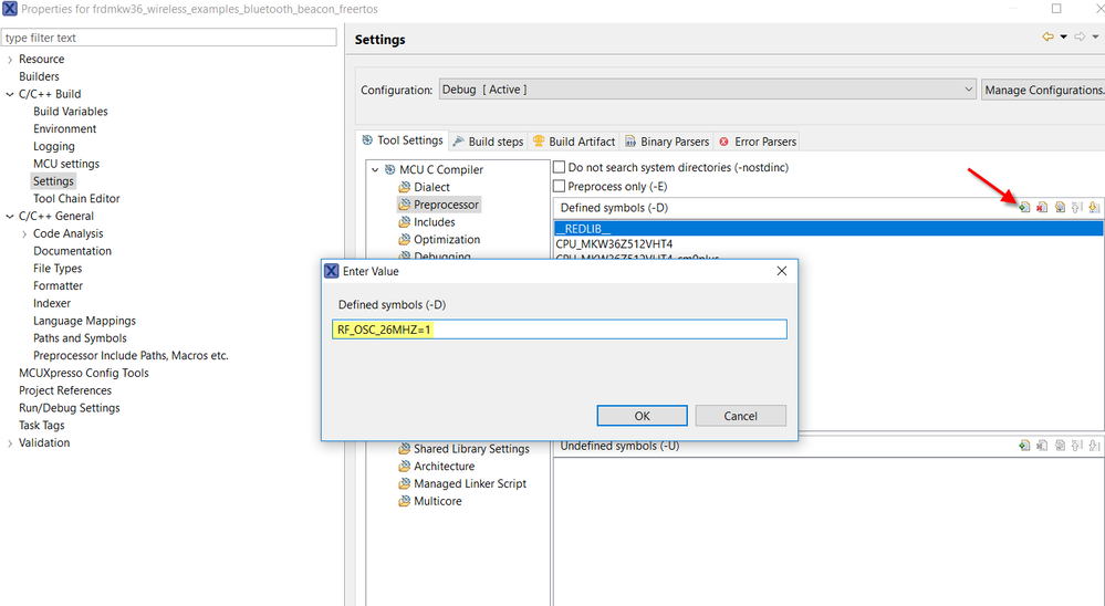

  • Click on add button from Defined symbols, write RF_OSC_26MHZ=1 and click OK to finish (Figure 6).
Figure 6. MCUXpresso Defined symbols
To finish, re-compile your project and it will be ready to operate with a 26MHz XTAL.
