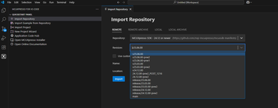

Step 2: Download and Install the SDK:
  • GUI Method:

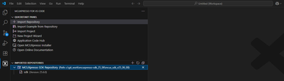

- Open VS Code, navigate to Import Repository and select the Remote option as shown below:

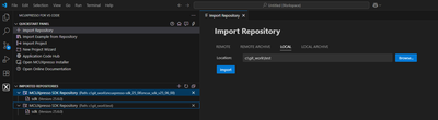

- Upon successful import, the repository will show up in the Imported Repositories window:

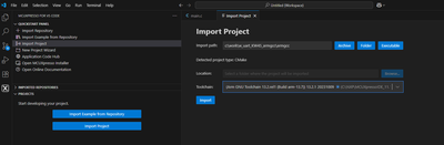

- import the local repository to VS code: Open VS Code, navigate to Import Repository and select the Local option and Browse.. to your local repo:

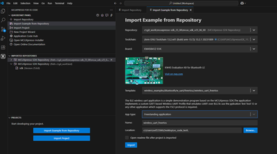

- click Import Example from Repository from the QuickStart Panel
From the open dialog, select the MCUXpresso SDK, the Arm GNU toolchain, your target board, desired template, and application type, and proceed by clicking Import:
For the application type, you’ll typically see two options:
- Repository application
- Freestanding application.
The key difference lies in where the project is imported. Repository applications are placed within the MCUXpresso SDK directory, while Freestanding applications can be imported to a custom location defined by the user.

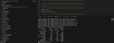

- Identify your project, right click and select the Prestine Build icon to begin building:
 - details of the build are into the terminal window:
- using Debug button will allow you to download and debug the software:

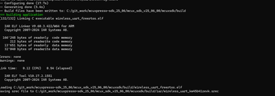

Once you've confirmed that the project is available for the IAR toolchain, run the appropriate command to build it:
west build -p always examples/wireless_examples/bluetooth/w_uart/freertos --toolchain iar --config debug -b kw45b41zevk
The build folder will contain the generated output:

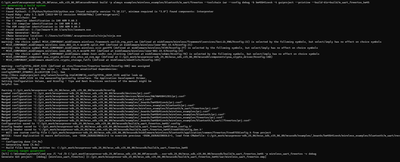

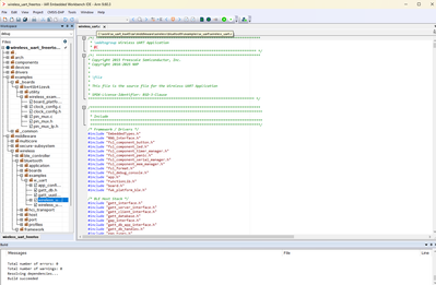

To work with IDE add  -t guiproject in the west command:
west build -p always examples/wireless_examples/bluetooth/w_uart/freertos --toolchain iar --config debug -b kw45b41zevk -t guiproject --pristine --build-dir=build/w_uart_freertos_kw45
 The result of the build will indicate the path to the *.eww/*.ewp:

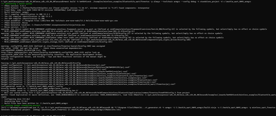

To generate a complete standalone project, the recommended method is using West by adding -t standalone_project option.
Example of command for kw45b41zevk, IAR toolchain:

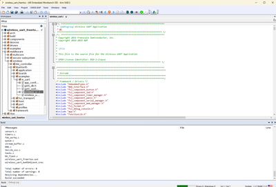

west build -b kw45b41zevk ./examples/wireless_examples/bluetooth/w_uart/freertos -p always --toolchain iar --config debug -t standalone_project -d c:\work\w_uart_kw45

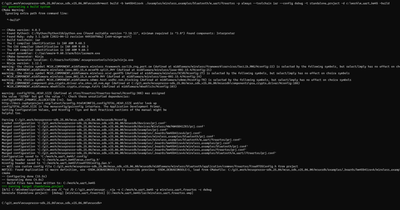

Example of command for kw45b41zevk, armgcc toolchain:
west build -b kw45b41zevk ./examples/wireless_examples/bluetooth/w_uart/freertos -p always --toolchain armgcc --config debug -t standalone_project -d c:\work\w_uart_KW45_armgcc
The result of the build will indicate the path to the project that need to be imported in VsCode:
