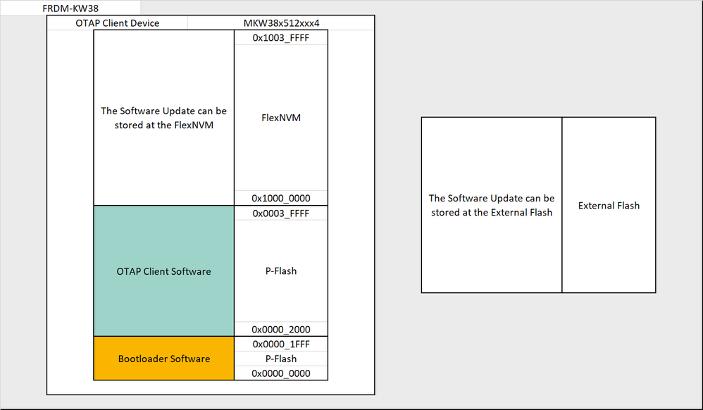

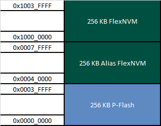

KW38 Flash Memory Used by the OTAP Client Software During the Update Process
By default, the 512KB KW38 flash memory is partitioned into:
  • One 256KB Program Flash array (P-Flash) divided into 2KB sectors with a flash address range from 0x0000_0000 to 0x0003_FFFF.
  • One 256KB FlexNVM array divided into 2KB sectors with address range from 0x1000_0000 to 0x1003_FFFF.
  • Alias memory with address range from 0x0004_0000 to 0x0007_FFFF. Writes or reads at the Alias memory modifies or returns the FlexNVM content, respectively. In other words, Alias memory is another way to refer to FlexNVM memory using different addresses.

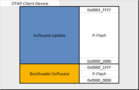

The following statements simplify how does the OTAP service work:

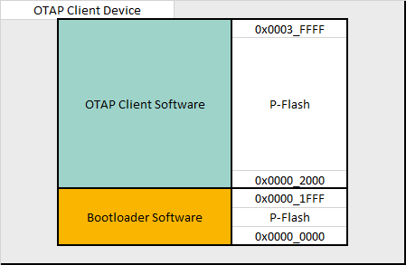

The OTAP application consists of two independent parts, OTAP bootloader, and OTAP client. The OTAP bootloader verifies if there is a new image available in the OTAP client to reprogram the device. The OTAP client software, on the other hand, provides the Bluetooth LE custom service needed to communicate the OTAP client device (device to be reprogrammed) with the OTAP server device (device that contains the image to reprogram the OTAP client device). Therefore, to prepare the software for the first time, the OTAP client device needs to be programmed twice, first with the OTAP bootloader, and then with the OTAP client software. The mechanism created to have two different software coexisting in the same device is storing each one in different memory regions. This is achieved by indicating to the linker file different memory regions on each individual software. For the KW38 device, the OTAP bootloader has reserved an 8KB slot from 0x0000_0000 to 0x0000_1FFF, thus the rest of the memory is reserved, among other things, by the OTAP client software.
When generating the new image file for the OTAP client device, we need to specify to the linker file that the code will be placed with an offset of 8KB (as the OTAP client software does), since these address range must be preserved to do not overwrite the OTAP bootloader. The new application should also contain the bootloader flags at the corresponding address to work properly (later we will return to this point).
While OTAP client and OTAP server devices are connected, and the download is in progress, the OTAP server device sends the image packets (known as chunks) to the OTAP client device via Bluetooth LE. The OTAP client device can store these chunks, in the external SPI flash (which is already populated on the FRDM-KW38) or in the on-chip FlexNVM region. The destination for these chunks is selectable in the OTAP client software (This post will give the instructions to modify the destination).

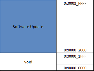

When the transfer of the image has finished, and all chunks were sent from the OTAP server device to the OTAP client device, the OTAP client software writes information such as the source of the software update (either external flash or FlexNVM) in a portion of memory known as bootloader flags. Then the OTAP client performs a software reset on the MCU to execute the OTAP bootloader code. Then, the OTAP bootloader code reads the bootloader flags to get the information needed to reprogram the device with the new application. See the following flow diagram which explains the flow of both applications.
Because the new application was built with an offset of 8KB, the OTAP bootloader programs the device starting from the 0x0000_2000 address, so, in consequence, the OTAP client application is overwritten by the new image. Then, the OTAP bootloader moves the flow of the application to start the execution of the new code.
In practice, the boundary between the OTAP client software and the software update when FlexNVM storage is enabled described in statement 3 is not placed exactly in the boundary of the P-Flash and FlexNVM memory regions, moreover, these values might change depending on your linker settings. To know where is located the boundary, you should inspect the effective memory addressing in your project.

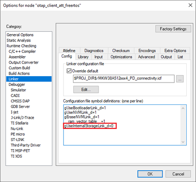

To select the external storage, follow the next steps (this is the default configuration in the SDK project):
4.1- Locate the "app_preinclude.h" header file in the source folder of your workspace. Search the "gEepromType_d" define and set its value to "gEepromDevice_AT45DB041E_c".
/* Specifies the type of EEPROM available on the target board */
#define gEepromType_d           gEepromDevice_AT45DB041E_c
4.2- Open the project options window (Alt + F7). Go to Linker->Config window and set "gUseInternalStorageLink_d=0".

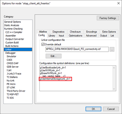

To select the internal storage, follow the next steps:
4.1- Locate the "app_preinclude.h" header file in the source folder of your workspace. Search the "gEepromType_d" define and set its value to "gEepromDevice_InternalFlash_c".
#define gEepromType_d           gEepromDevice_InternalFlash_c
4.2- Open the project options window (Alt + F7). Go to Linker->Config window and set "gUseInternalStorageLink_d=1".

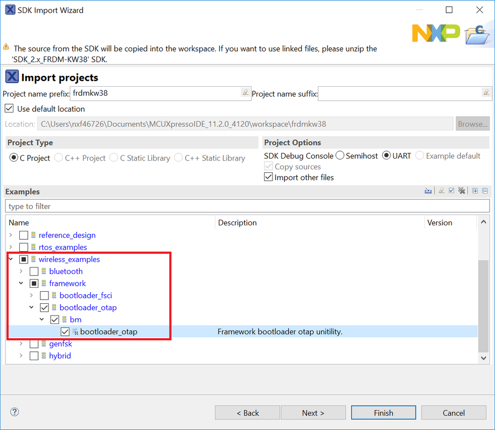

3- Import the OTAP bootloader project. It is located in "wireless_examples -> framework -> bootloader_otap -> bm -> bootloader_otap". Click on the "Finish" button.
4- Program the OTAP bootloader project on your board by clicking on the "Debug" icon Untitled.png. Once the KW38 was programmed and the debug session begun, abort the session Untitled.png (Ctrl + F2) to stop the MCU safely.

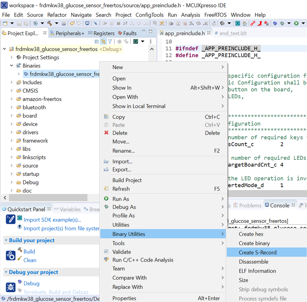

1- Import any example from your SDK package in the Bluetooth folder as explained previously. Bluetooth examples are located in "wireless_examples -> bluetooth" folder in the SDK Import Wizard. This example will make use of the glucose sensor project in "wireless_examples -> bluetooth -> glucose_s -> freertos -> glucose_sensor_freertos". See the picture below.
2- Navigate to "Project -> Properties -> C/C++ Build -> MCU settings -> Memory details". Edit the Flash fields as shown in the figure below, and leave intact the RAM. The last fields indicate to the linker file that the image must be addressed after the first flash sector, to do not overwrite the OTAP bootloader software, as we stated in the introduction of this post.
3- Unzip your KW38 SDK package. Drag and drop the "main_text_section.ldt" linker script from the following path to the "linkscripts" folder on your workspace. The result must be similar as shown in the following figure.
<KW38_SDK>\middleware\wireless\framework\Common\devices\MKW38A4\mcux\linkscript_bootloader\main_text_section.ldt
4- Open the "end_text.ldt" linker script file located in the linkscripts folder in MCUXpresso IDE. Locate the section shown in the following figure and remove "FILL" and "BYTE" statements. BYTE and FILL lines are used to fill with a 0xFF pattern the unused NVM flash memory region. Removing this code, our software image will not contain this pattern, in consequence, the image reduces its total size and it improves the speed of the OTAP download and memory usage.
5- Open the "app_preinclude.h" file, and define "gEepromType_d" as internal storage. This is a dummy definition needed to place the bootloader flags in the proper address, so this will not affect the storage method chosen before when you programmed the OTAP client and the OTAP bootloader software in your MCU.

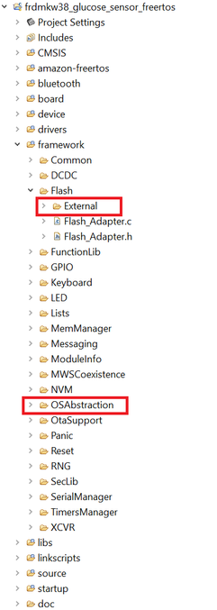

6-  Include in your project, the "OtaSupport" folder and its files in the "framework" folder of your project. Include as well the "External" folder and its files in the "framework -> Flash" folder of your project. "OtaSupport" and "External" folders can be found in your SDK. You can easily drag those folders from your SDK download path and drop it into your workspace in MCUXpresso to include them. "OtaSupport" and "External" folders are located at:
OtaSupport
<KW38_SDK>middleware\wireless\framework\OtaSupport
External
<KW38_SDK>middleware\wireless\framework\Flash\External
The result must look like the following picture:

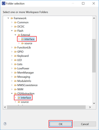

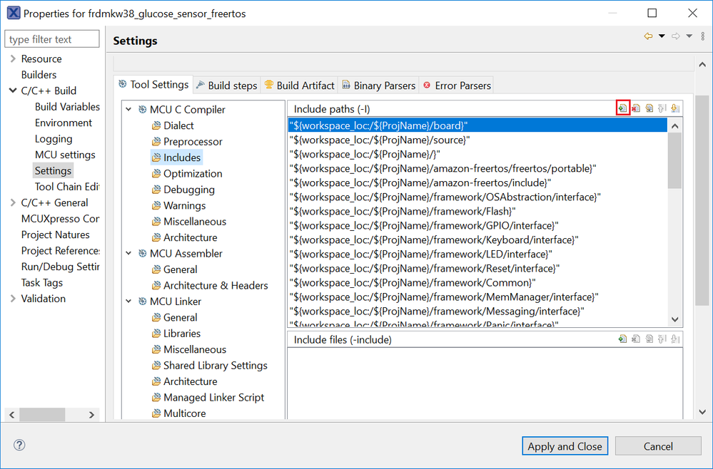

7- Go to "Project -> Properties -> C/C++ Build -> Settings -> Tool Settings -> MCU C Compiler -> Includes". Click on the icon next to "Include paths" (See the picture below). A new window will be displayed, then click on the "Workspace" button.
8- Deploy the directory of the project in the "Folder selection" window, and select "framework -> Flash -> External -> interface" and "framework -> OtaSupport -> interface" folders. Click the "OK" button to save the changes.Untitled.png
9- Ensure that "OtaSupport" and "External" folders were imported in the "Include paths" window. Then save the changes by clicking on the "Apply and Close" button.
10- Save and build the project by clicking this icon Untitled.png. Then, deploy the "Binaries" icon in your project. Click the right mouse button on the ".axf" file and select the "Binary Utilities -> Create S-Record" option. The S-Record file generated will be saved in the Debug folder in your workspace with ".s19" extension. Save the S-Record file in a known location on your smartphone.

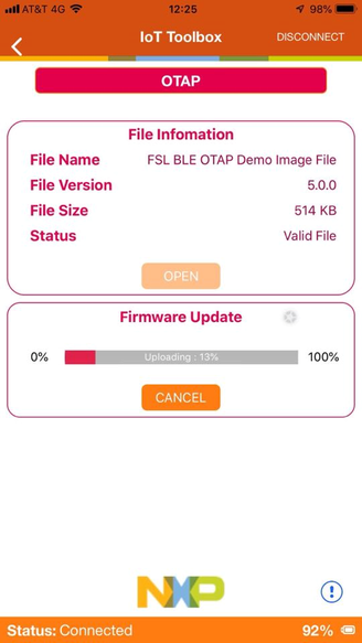

1- Open the IoT Toolbox App on your smartphone. Select OTAP and click "SCAN" to start scanning for a suitable OTAP Client device.
 2- Press the ADV button (SW2) on your FRDM-KW38 board to start advertising.
3- Once your smartphone has found the FRDM-KW38 board, it will be identified as "NXP_OTAA". Connect your smartphone with this device. Then a new window will be displayed on your smartphone.
 4- Click the "Open" button and search for the SREC software update.
5- Click "Upload" to start the transfer. Wait while the download is completed. A confirmation message will be displayed after a successful update.
 6- Wait a few seconds until the software update was programmed on your MCU. The new code will start automatically.
