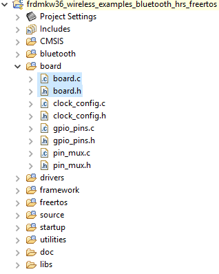

  1. Open or clone the Heart Rate Sensor project from your SDK.
  2. Find the board.c and board.h files in the board folder at the workspace.                                                                               pastedImage_13.png

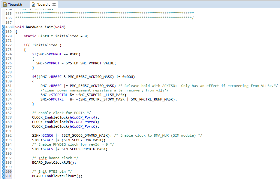

  6. Call the BOARD_EnableRtcClkOut function in hardware_init function just after BOARD_BootClockRUN (board.c file).pastedImage_18.png
