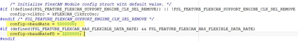

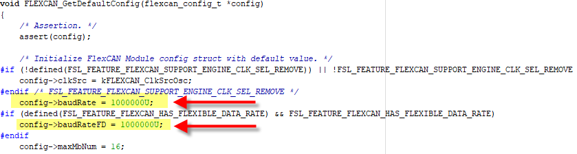

FRDM-KW36 Software Development Kit (SDK) includes drivers and examples of FlexCAN module for KW36 which can be easily configured for a custom communication. For example, if user want to change the default baud rate from FlexCAN driver demo examples then the only needed change is the default value on "config->baudRate" and "config->baudRateFD" from "FLEXCAN_GetDefaultConfig" function (See Figure 1). Segments within a bit time will be automatically configured to obtain the desired baud rate. By default, demos are configured to work with CAN FD communication.
Figure 1. FRDM-KW36's default baudrate from flexcan_interrupt_transfer driver example

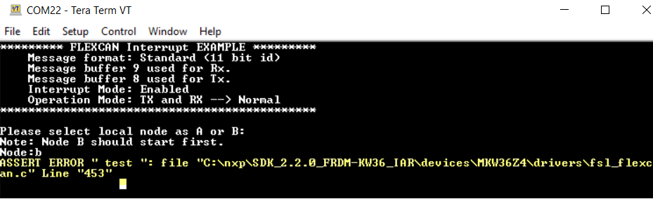

An example occurs by setting the maximum FD baud rate "3.2MHz" using the 32MHz xtal or "2.6MHz" using a 26MHz xtal where demo reports an error. See Figure 2.
Figure 2. Error by setting maximum baud rate

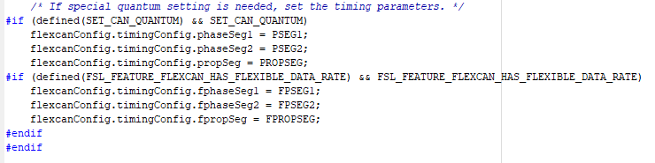

When this error occurs, the fix is on setting the timing config parameters correctly by including the definition of SET_CAN_QUANTUM on application source file (see Figure 3) and then declare and initialize the timing config parameters shown in Figure 4.
Figure 3. SET_CAN_QUANTUM define

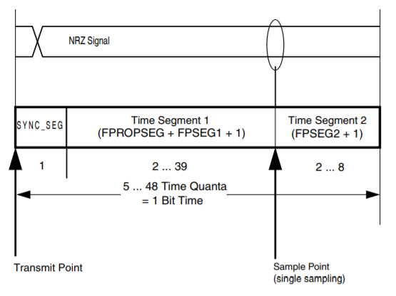

KW36 Reference Manual in chapter "37.4.8.7 Protocol timing" shows the segments within a bit time for CAN nominal phase configured in "CAN_CTRL1" register (see Figure 6), and segments for FD phase configured in CAN_FDCBT register (see Figure 7).
2.pngFigure 6. Segment within a bit time for CAN nominal phase
Figure 7. Segment within a bit time for CAN FD phase

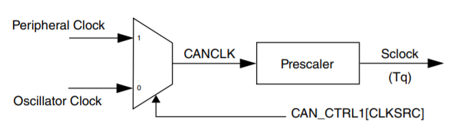

CANCLK can be selected by CLKSRC bits on CAN_CTRL1 register as shown in Figure 9, where the options are Peripheral clock=20MHz or Oscillator clock (16MHz if using 32MHz xtal or 13MHz if using 26MHz xtal). The recomiendation is to use the Oscillator clock due to peripheral clock can have jitter that affect communication.
6.pngFigure 9. CAN clocks
To select the Oscillator clock, search for flexcanConfig.clkSrc definition and set it to kFLEXCAN_ClkSrcOsc as shown in Figure 10.
Figure 10. CANCLK selection
