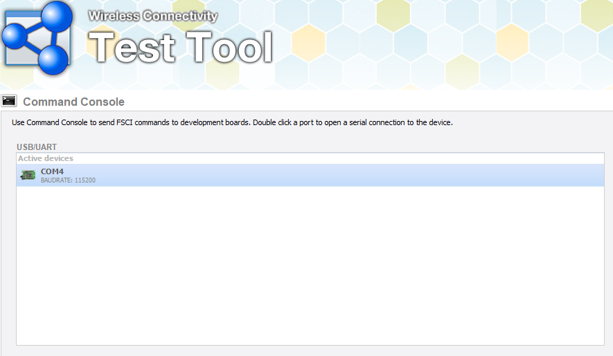

Once you have installed Test Tool, attach the FRDM-KW36 board to your PC and open the serial port enumerated in the start page clicking twice on the icon.pastedImage_77.png

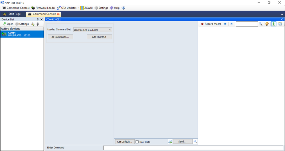

Then, select "Raw Data" checkbox and type any of our custom commands, for instance, "01 01 FC 00" (Set the Channel 19 Freq 2440 MHz). Shift out the command clicking on the "Send Raw..." button.
You will see the HCI Tx and Rx in the right upper corner of your screen

There is no raw data.

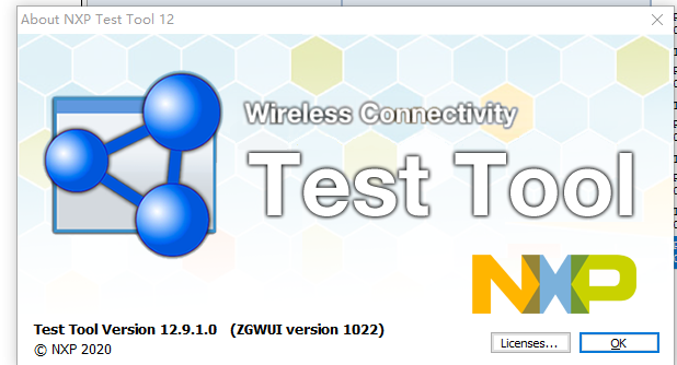

Hello, [email protected]‌
I have confirmed that the "Raw Data" option is also available in the Test Tool 12 v12.9.1.0. Please ensure that you are in the correct window. After opening the serial port communication, a new window will be displayed (Command Console window) and here you will see this option in the lower part of the screen. Please, see the following picture:
If the option does not appear, I recommend upgrading to the newest version of Test Tool 12 and try again.
