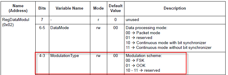

As know, FSK and OOK are the modulation types that can be configured in the radio by setting the bits 4-3 from the RegDataModul register, as shown in below picture taken from Reference Manual:
A common inquire you could have is: what modulation should I use? Let's first understand how these modulations work.

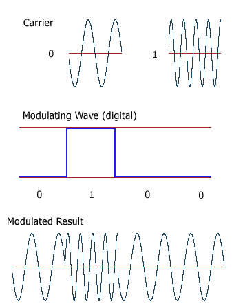

FSK:
Frequency Shift Keying is a modulation type that uses two frequencies, for 0 and 1.
In a spectrum analyzer we can see a spectrum similar to the next picture, where the frequency for 0's is separated from the central frequency with FDev, and same case for the frequency for the 1's:

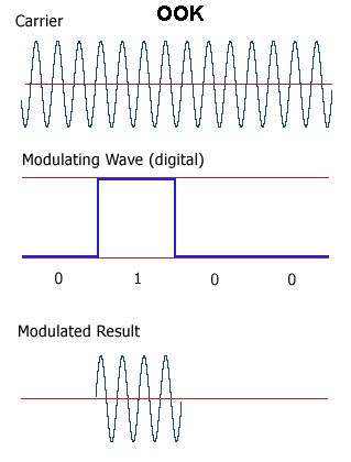

OOK:
On Off Keying is a modulation type that represents a logic 1 with the presence of the carrier frequency and a logic 0 with the absence of it.
In a spectrum analyzer we can see a spectrum similar to the next picture, where the central frequency represents a logic 1. We can not see a logic 0 in the spectrum due to it's represented as the absence of power.
