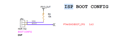

JP4
1x2 pin header
Target MCU boot configuration enable jumper:
Open (default setting): ISP mode is disabled
Shorted: ISP mode is enabled

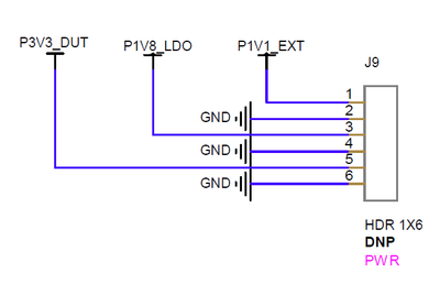

  • Populate J9 PWR connector. To run KW47 M2 as standalone, supply 3.3V to P3V3_DUT power rail

External power configuration (KW47-M2)
Enable KW47-M2 by supplying power through J9 connector:
Note: When using DCDC or LDO mode, it is recommended to supply P3V3_DUT power rail only.
Part Identifier
pin
Description
J9
5
Use this pin to supply P3V3_DUT power rail with 3.3V. To get KW47-M2 up and running, it is recommended to set KW47 to DCDC mode and supply P3V3_DUT only.
J9
3
Use this pin to supply P1V8_LDO power rail with 1.8V. This power rail is intended for an accurate control of VDD_RF power domain, but it is not necessary.
J9
1
Use this pin to supply P1V1_EXT power rail with 1.1V. This power rail is intended for an accurate control of VDD_CORE power domain, but it is not necessary.
Programming the NBU in the KW47-M2 board
The following steps guide you to program the NBU software for the KW47-M2
  1. Place a jumper on the JP4 header while holding down the reset button (SW) on the module board. Then, connect the USB cable to the J8 connector (USB-to-serial bridge) and plug it into your computer. After the USB cable is connected, release the reset button.

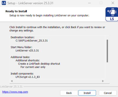

  1. Verify what COM Port was assigned to your KW47-M2 board. You can check the COM Port assigned in the Windows “Device Manager” program. Search for “Ports (COM & LPT)” and save the COM Port number. In this example the COM Port assigned was “COM19”
  1. Navigate to your computer to the MCU-Link installation folder. The default installation path is located at “C:\nxp\LinkServer_25.3.31\MCU-LINK_installer
  2. Locate the “bin” folder and open it. Run the script “blhost” within a windows command prompt.
Type “blhost.exe -p COMX write-memory 0x48800000”, drag and drop the NBU binary file. When the process is ready you will see the response status "success"
