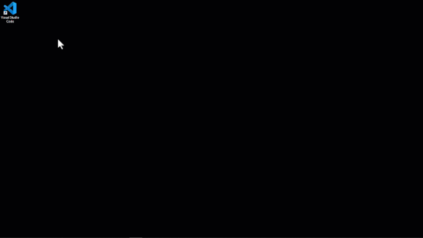

2. Install Visual Studio Code (VS Code)
Microsoft allows users to quickly install VS Code from https://code.visualstudio.com/download. The link allows the user to select the appropriate download for their OS.
The following instructions are for a Windows installation.  However, most of the following steps also apply to Mac and Linux users.
It can be helpful for new users to directly install VS Code and the NXP extension.  This can be done by sharing one of two links:
If VS Code exists on the system, the user will be taken to the NXP MCUXpresso for VS Code extension in the Microsoft Marketplace.  If VS Code is NOT installed on the system the user will be guided through the install of VS Code.
At this point the VS Code application should be installed on the laptop.

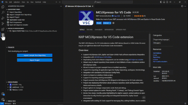

3. Install MCUXpresso for VS Code Extension
The user can install or update the MCUXpresso for VS Code extension from within VS Code.  The following steps outline how.  A short clip is included to show the steps.
  1. Open VS Code.  Launch program from desktop.
  2. Open the Extensions Marketplace.  Click on Icon of 4 blocks in left navigation VSCode-Extension-Icon.png or use Ctrl-Shft-X.
  3. Search "NXP" or "Mcuxpresso" in the Extension search window at the top left.
  4. MCUXpresso for VS Code extension will be displayed.  Click on listing.
  5. Click on blue Install button in the Extension Overview that is opened in the editor.
  6. The Extension is properly installed when the following NXP icon is shown in left navigation. VSCode-NXPExtension-Icon.png
At this point the VS Code application now includes the NXP MCUXpresso extension.

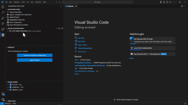

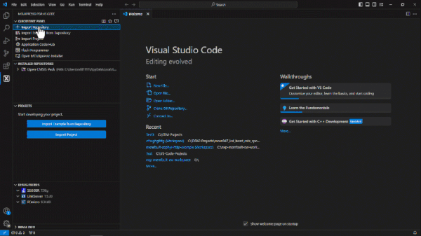

5. Import NXP Matter Repository
The MCUXpresso for VS Code extension simplifies how the user can add Matter to their workspace.  The repository import wizard automates most of the steps required for a user to get started with Matter.
The following steps show how to add Matter Repository.  2 short clips are included to show the steps.
  1. Click on "Import Repository" found under Quickstart Panel in upper left.
  2. Click Repository found in the wizard's Remote tab.
  3. Select "NXP Matter".  This automatically targets the NXP/Matter repo found on GitHub.
  4. Enter a desired location to clone/store the NXP Matter repository.  Closer to C:/ is better.
  5. Select "release/v1.4.0" listed as an available version under Revision:
  6. Click Import
The import process can take ~30 minutes depending on network bandwidth and IT software.
NOTE: This is similar amount of time when using CLI in a terminal.
After the repo is cloned, the Matter Bootstrap script is used to setup matter environment.
At this point the user laptop has a valid Matter workspace.  The workspace is now capable of importing and building Matter projects.

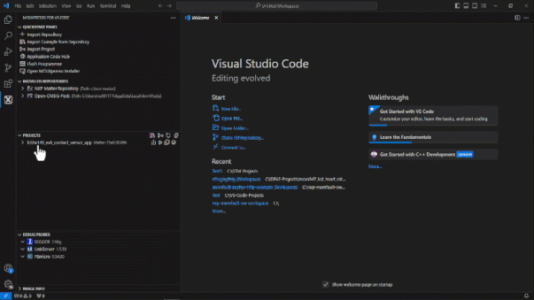

7. Build Matter Project
Building the project is the final step for Getting Started with a Matter project in VS Code.  The extension has properly setup the project toolchain and will build successfully.  The NXP extension reduces the setup time by not importing the SDK for all supported boards.  The board SDK is automatically imported/cloned when it is not located on the 1st build for a board.  Successive projects for the same board will not require this additional step/delay.
The following steps show how to build a matter project in the workspace.  A short clip is included to show the steps.
  1. Select the Matter project listed under the Projects pane located in the primary left sidebar.  When selected, project control icons are revealed to the left of the project name.
  2. Click on the Build icon.
  3. Verify the build was successful by viewing the binary files with File Explorer.  Click the File Explorer icon to the right of project name or in the upper left of the side bar navigation.  The binary is found under the project's \out\debug folder.
This exercise on "Getting Started with Matter" is completed.  At this point the Matter project imported to the workspace was successfully built.
