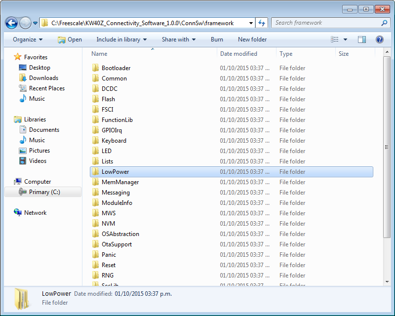

Once you have installed the “Connectivity Software” package, browse for the extracted files (typically located in C:\Freescale\KW40Z_Connectivity_Software_1.0.0). In this location search for the LowPower folder, then copy and paste it into your new project folder.

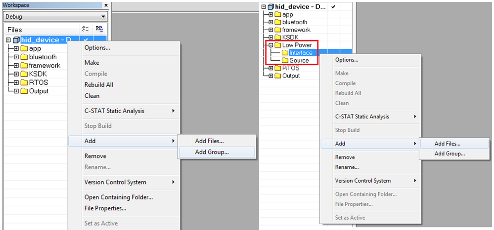

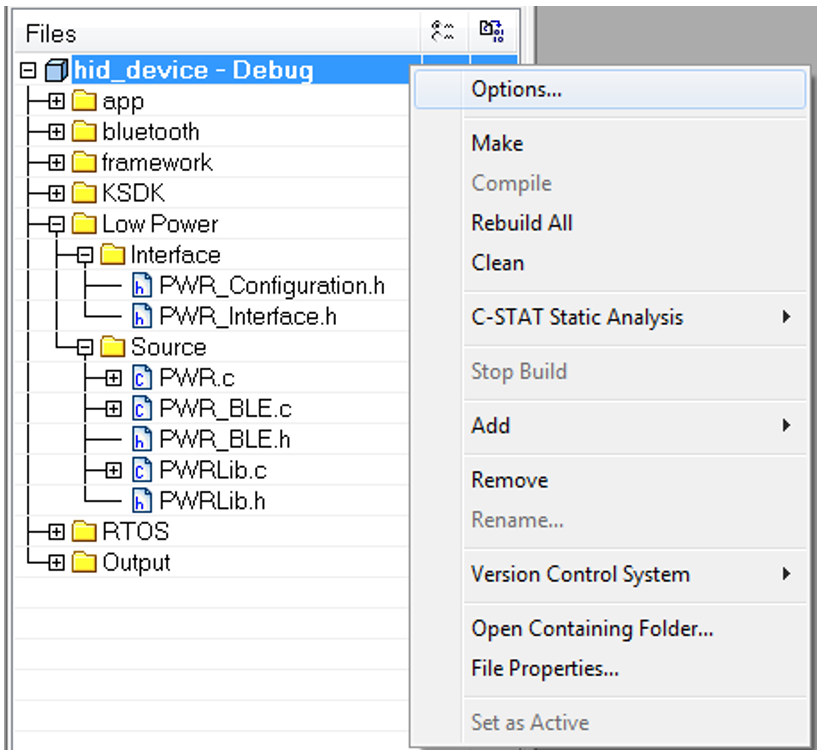

Open your IAR project and create a new group called “Low Power”. Inside this group add two new groups called “Interface” and “Source”. In the Windows explorer, open the LowPower folder copied in the previous step. Drag and drop the contents of the "Interface" folder to the "Interface" group in IAR. Do the same for the "Source" folder. You can also use the option "Add Files" in the group menu to add the files.
Note: Do not copy the “PWR_Platform.c” and “PWR_Platform.h” files.

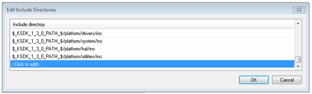

Once you have copied the files in their respective folders, you need to add the paths of these files in the project environment. Right click on the project name and select "Options".
In Options go to “C/C++Compiler”, select “Preprocessor” and click on the red square.
The next window will appear. Click on <Click to add>  to open the windows explorer. Navigate to the folder PowerLib/Interface in your project to add the "Interface" folder path. Repeat this step with the "Source" folder.
