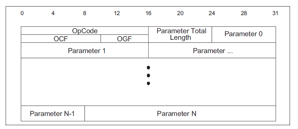

HCI Application is a Host Controller Interface application which provides a serial communication to interface with the KW40/KW41/KW3x/QN9080 BLE radio part.
It enables the user to have a way to control the radio through serial commands.
The format of the HCI Command Packet is composed by the following parts.
HCI_packet.pngFigure 1. HCI Command Packet
Each command is assigned a 2 byte Opcode which is divided into two fields, called the OpCode Group Field (OGF) and OpCode Command Field (OCF).
The OGF uses the upper 6 bits of the Opcode, while the OCF corresponds to the remaining 10 bits.
The OGF of 0x3F is reserved for vendor-specific debug commands. The organization of the opcodes allows additional information to be inferred without fully decoding the entire Opcode.
For further information regarding this, please check the BLUETOOTH SPECIFICATION Version 5.0 | Vol 2, Part E, 5.4 EXCHANGE OF HCI-SPECIFIC INFORMATION.
