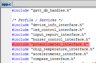

Once the files are included in the project, the service must be initialized in the stack. File app.c is the main application file for the NXP BLE stack. It calls all the BLE initializations and application callbacks. The service_interface.h file must be included in this file.
Figure 5 Interface header inclusion

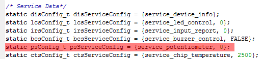

Then in the local variables definition, a new service configuration variable must be defined for the new service. The type of this variable is the one defined in the service interface file and must be initialized with the service name (defined in gattdb.h) and the initial values for all the characteristic values.
Figure 6 Service configuration struct
