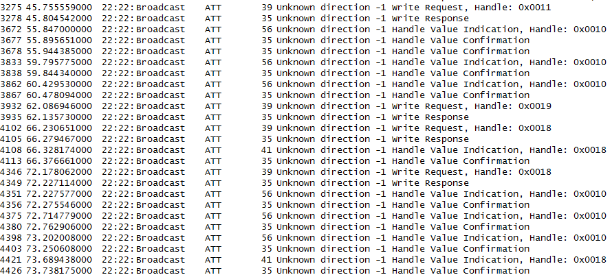

To test the demo you can download and install a BLE Scanner application to your smartphone that supports BLE. Whit this app you should be able to discover the services in the sensor and interact with each characteristic. Depending on the app that you installed, it will parse known characteristics, but because the PLX profile is relatively new, these characteristics will not be parsed and the values will be displayed in a raw format. In Figure 1, the USB-KW40Z was used with the sniffer application to analyze the data exchange between the PLX sensor and the client. You can see how the sensor sends the measurements, and how the client interacts with the RACP characteristic.
Figure 1. Sniffer log from USB-KW40Z
